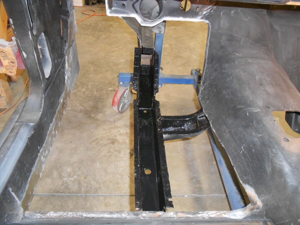

With the frame rail replacement you used two piece not one? Would it have been better to make out of one? I ask because I'm in a similar situation with my fastback, I have a DSE Aluma-frame also. Any suggestions?

Heres mine.
Passenger side...
Drivers...
  #114

Brian did not replace the frame rail only cut out the rust and made a patch. On yours it looks like you have a lot of rust and I would replace.
