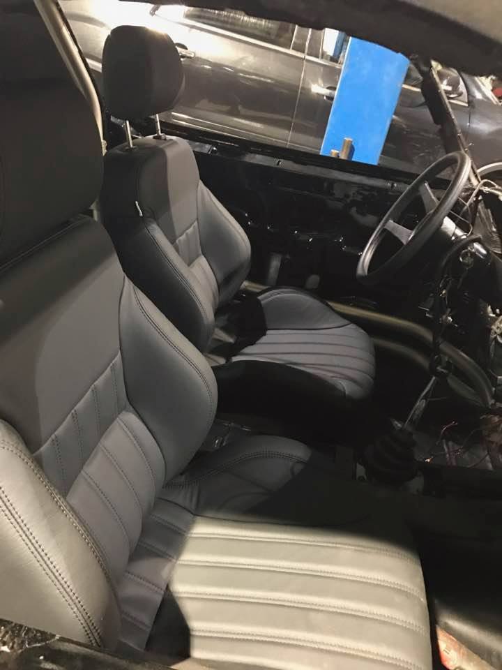

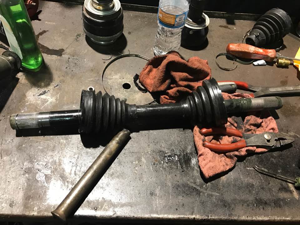

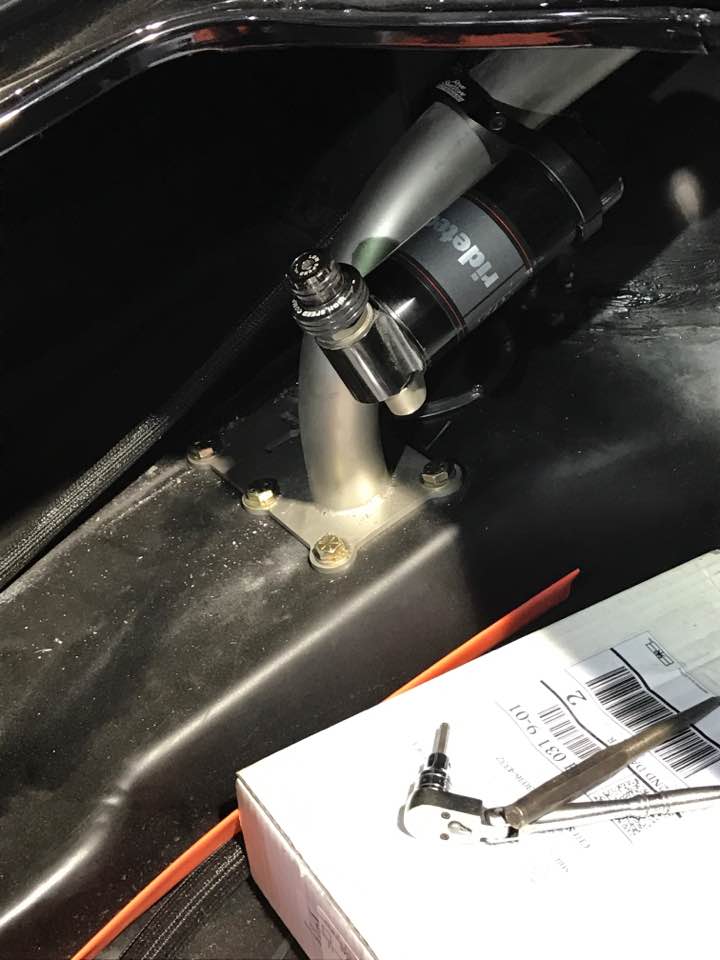

Started getting the interior together.
Also got the rear axle shaft back, so I can put all that to rest, too.
Little stuff now, like getting the Ride Tech cans into the trunk on the Ron Sutter brackets.
Still trying to hunt down a dash. I don't want to use repop stuff.
