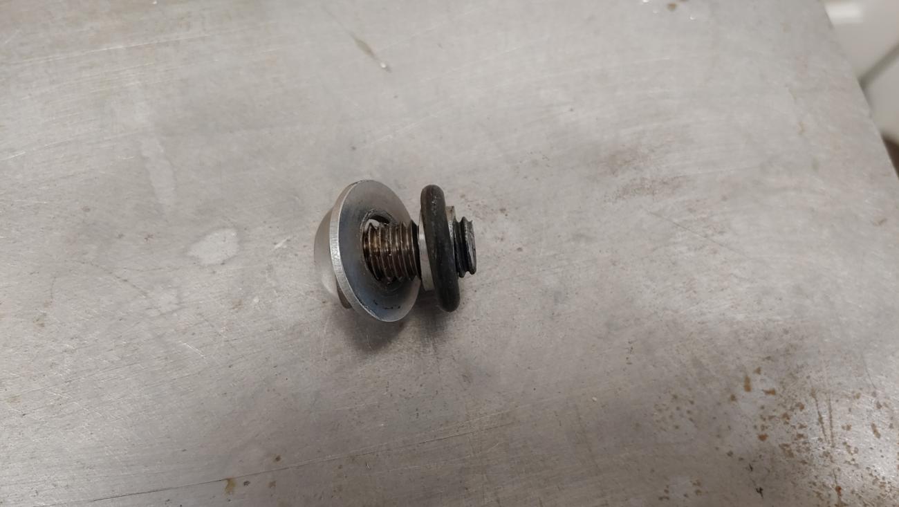

Here is the way AutoRad does it. The bolt cinches down tight on the short shaft collar, squeezes the o-ring a bit (not a lot - it mostly floats in the large hole in the rad), allowing the radiator to be captured but still float. Food for thought.
Attachment 73518
Attachment 73519
Here is what I plan to use. (( Well nut to scale ))

So I did a little research and found that a Radiator thermal expansion can be as much as 3mm which should easily be covered by the well nuts in all directions. The well nuts I have are 3/4" so this should allow for plenty of movement.
What's your thoughts guys ?

I think that's what I was told as well. About 3mm of swelling. The bottom being in the factory saddle isolators and one of the well type bushings on each side that allows for movement in all directions should be ok, but again, just guessing. It needs to be able to move without moving too much.
ALL DIRECTIONS is important cos twisting of the radiator support panel occurs when u enter an uphill driveway at an angle (one front wheel up to bump). This twist will also tear a radiator apart.
Well Nuts are good but painful to hold the rubber from turning, gripping with MULTIGRIPS will tear the brass insert from the rubber. Lube the thread and don't over tighten.
My suggestion would be wiring grommets and fender washers in top holes with Nyloc nuts barely tight...... and a rubber support pad in a bottom channel.
