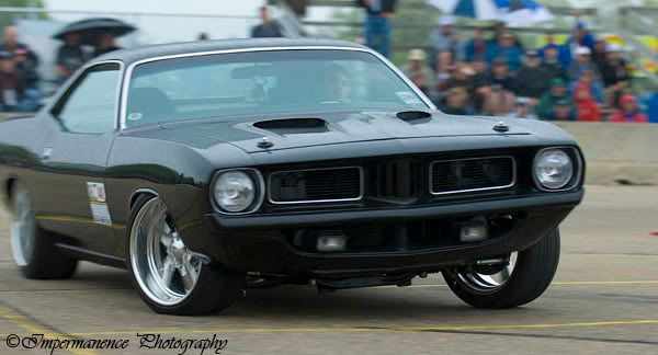

Southern Auto Air, I changed the mounting of the a/c condensor so it's horizontal now(I called them and they said not to put it vert.), as for update I've been pounding the hell out of her just got back from motorstate and it did well, besides it needs a little bigger brake system, we were about in the middle of the pack on the auto cross so not to bad still trying to figure out where to set the ride height, it likes to roll over really bad unless theres a ton of air in it so I'll have to work on that a little, I still have a couple things to finish a little wireing and the a/c needs to be charged. telly
