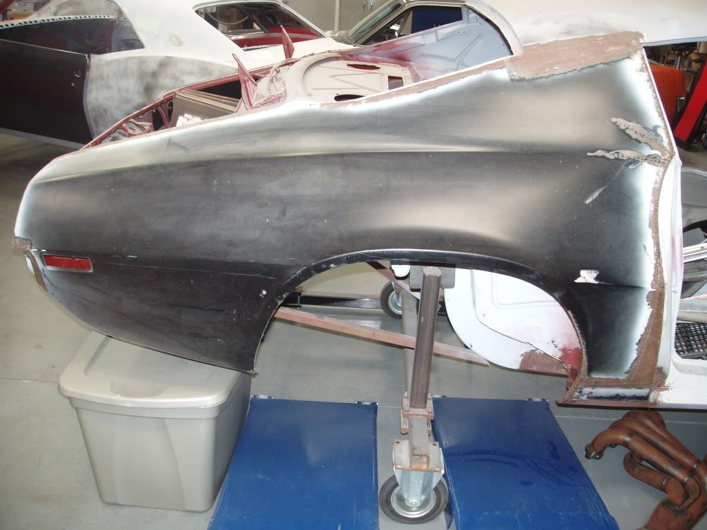

Originally Posted by Gonzo View Post
We did this on my 70 Z28! The second gen is has proven to be a challenge cause the door opening is very close to the wheel opening & it causes the lines to pull up.. On my 70 we have it pulled 1 inch on one side & 2 inches on the other side.. We were able to fit a 335 with the 2 inch pull Post pics tomorrow!
Thanks. I am looking forward to seeing it.

Originally Posted by Kendall Burleson View Post
Randy Clark( hot rod and custom stuff) did a firebird the same way killer job.

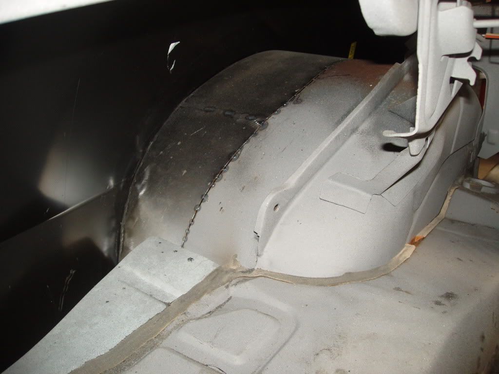

Old 11-24-2009, 11:01 AM
Cris@JCG's Avatar
Cris@JCG Cris@JCG is offline
Join Date: Apr 2009
Location: Oxnard, CA
Posts: 1,915
Thanked 4 Times in 4 Posts

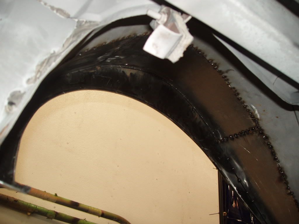

Default 67 inner well
Here is what the inner wells look like!

Default 70 Camaro Stretch
This is what it looks like when we stretch a 70.. The body line towards the door can be a challenge!
2 inch on pass side
1 inch on driver side
