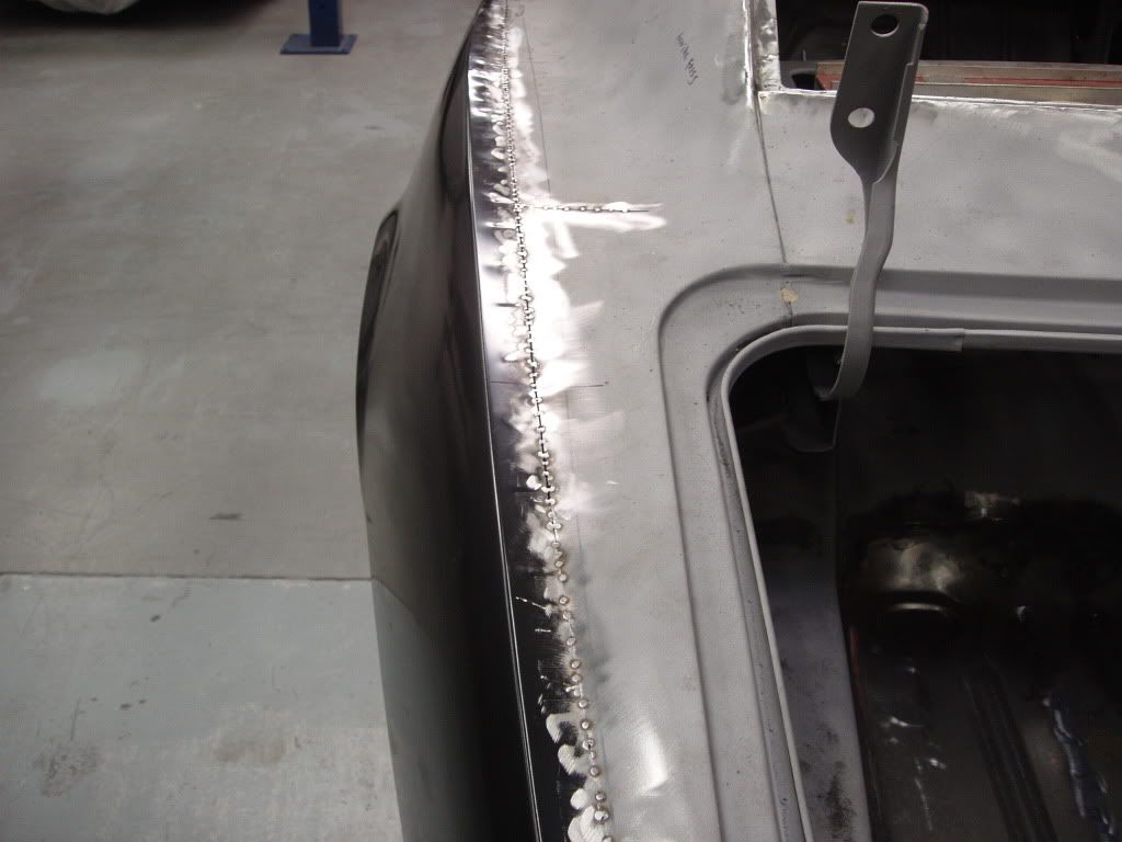

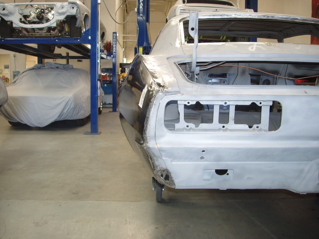

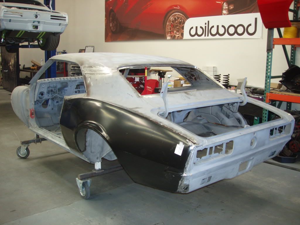

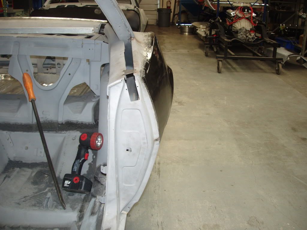

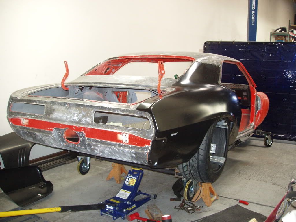

Lately I have been widen Camaros to give them a more aggressive look & tire room for bigger tires without mini-tubing, we are able to pull about 2 inches per side.. Going back to Trans Am days of flaring.. We have done this on67,68,69 & 70's Camaros.. Each have been different processes but are narrowing it down to what you see in the pics..

It is hard to estmate cause each job is different.. But are about 25 hrs on the side you see here on the 67..
