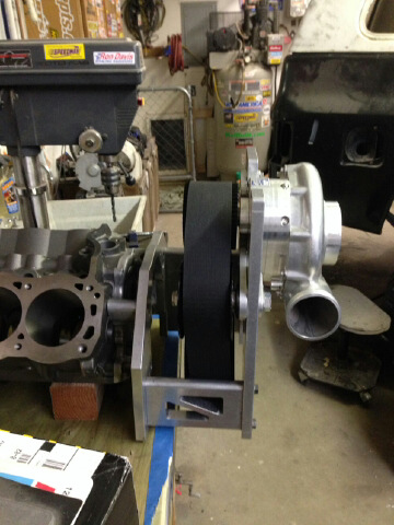

See the new block and the supercharger

Those ladder bars are HILARIOUS!!! That is really going to throw people for a loop.

x2 I like that wood covering.
That's a monster blower.

Yeah I really thought it would be funny watching the NHRA tech look under the car and BAM! Broom stick?
The blower is a Procharger F1X with a front mount bracket. The radiator will be horizontially(more of an angle actually) mounted with a dual blow thru fan set-up.
The new engine is a Dart Iron eagle filled with Callies Crank, Oliver Billet Rods, Racetec pistons and a Danny Bee belt drive.

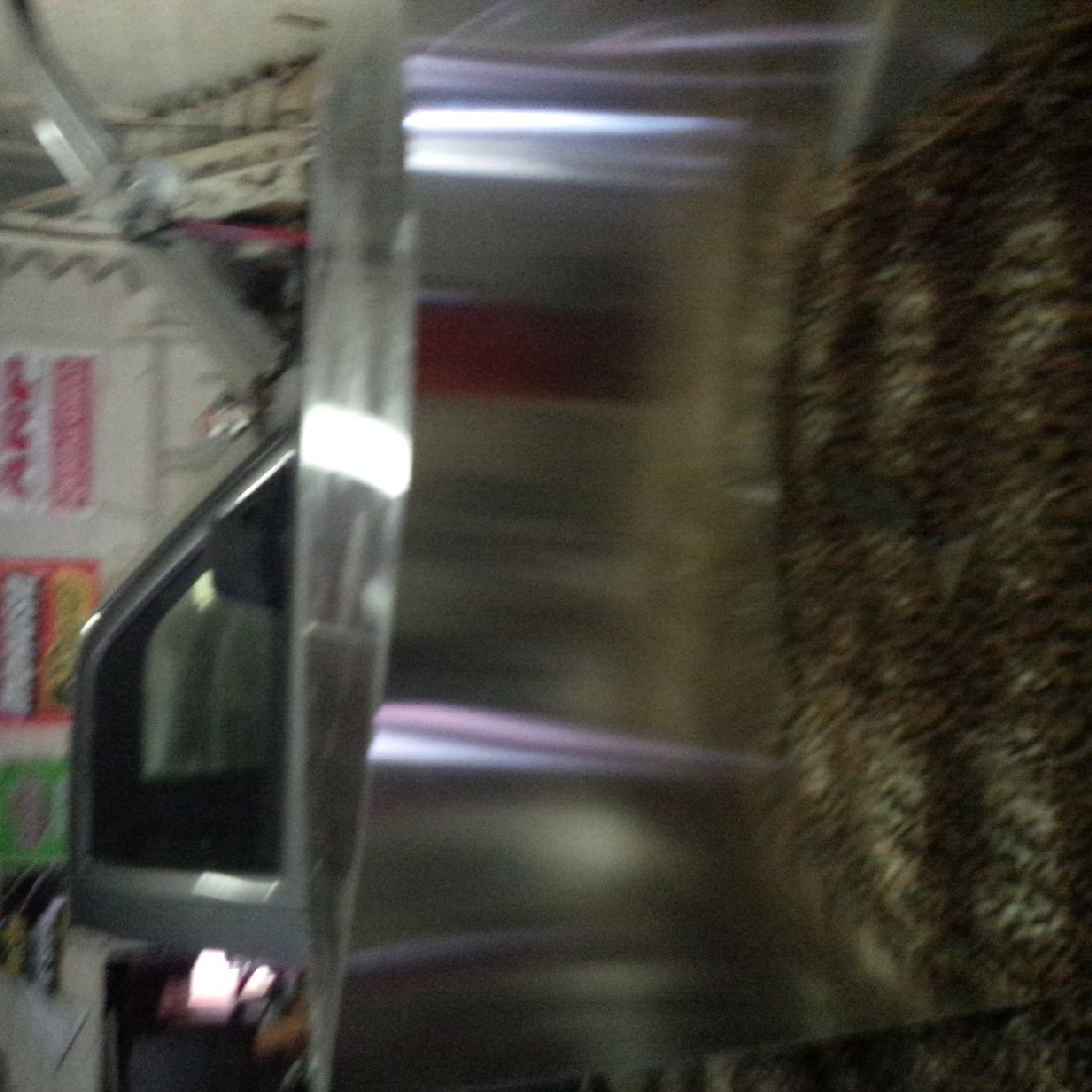

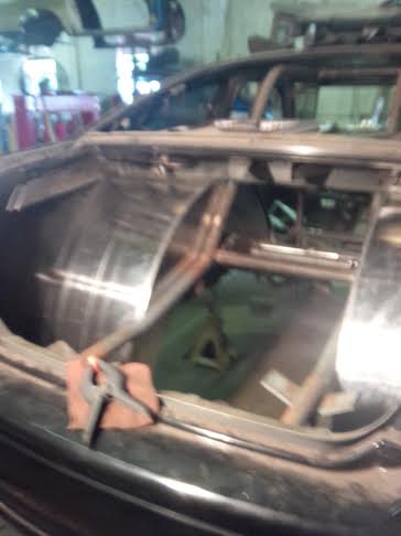

Default Sheetmetal
Well finally got enough spare time to start the interior sheetmetal. Made both tubs last night. They are freaking huge but it allows me to slam the car low and not worry about tire growth or shake. ended up 44' front to back with an average width of 23". First time making them so it was pretty cool. Once everything is fitted it all goes out for hydrocoating.
  #36
Old 07-23-2014, 07:49 AM
214Chevy's Avatar
214Chevy 214Chevy is offline
Join Date: Jul 2008
Location: DALLAS, Texas
Posts: 4,699
Thanks: 459
All I see is a big blur. C'mon bro...we need better pics.

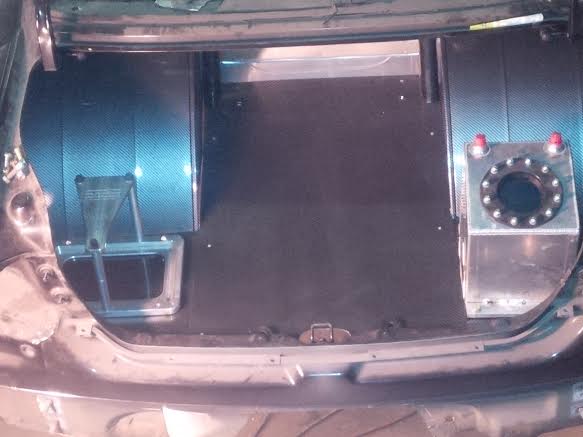

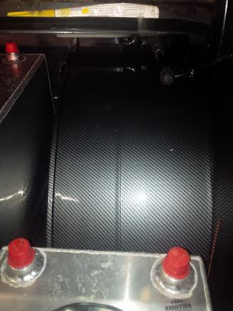

Default Better pics
Mcilwaine actually got them both installed today so here they are.

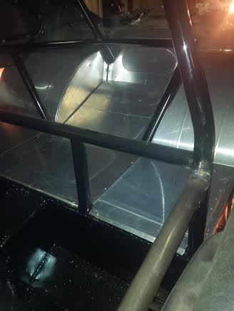

Default Sheetmetal in
Sheetmetal is in and getting ready to paint the rollbar then rivet. Core support is being cut out as well to make room for the supercharger.
