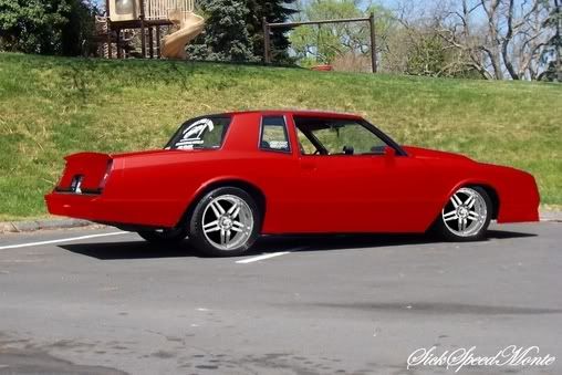

Not 100% sure on wheels, I just know I want to go with 18's. For the front brakes I have a set of Wilwood SLP6 6 piston calipers, and plan on going with a pair of 4 pistons for the rear. Body color will be Kandy Apple Red (House of Kolor). Here is a photo shop pic I had a member on montecarloss.com do of his car, and it is very similar to what I want mine to look like. The wheels are Bonspeed Deltas, but I'm not sure on them yet.

Some great ideas you have there. I'm glad we have more G-bodys getting into the pro-touring theme. I love how you used sickspeed's pic for your photoshop.

Looks good i would make the spoiler taller or lay it back more and use the 87/88 tail lights and rear bumper but that's just me tho.

I like that, looks great!
