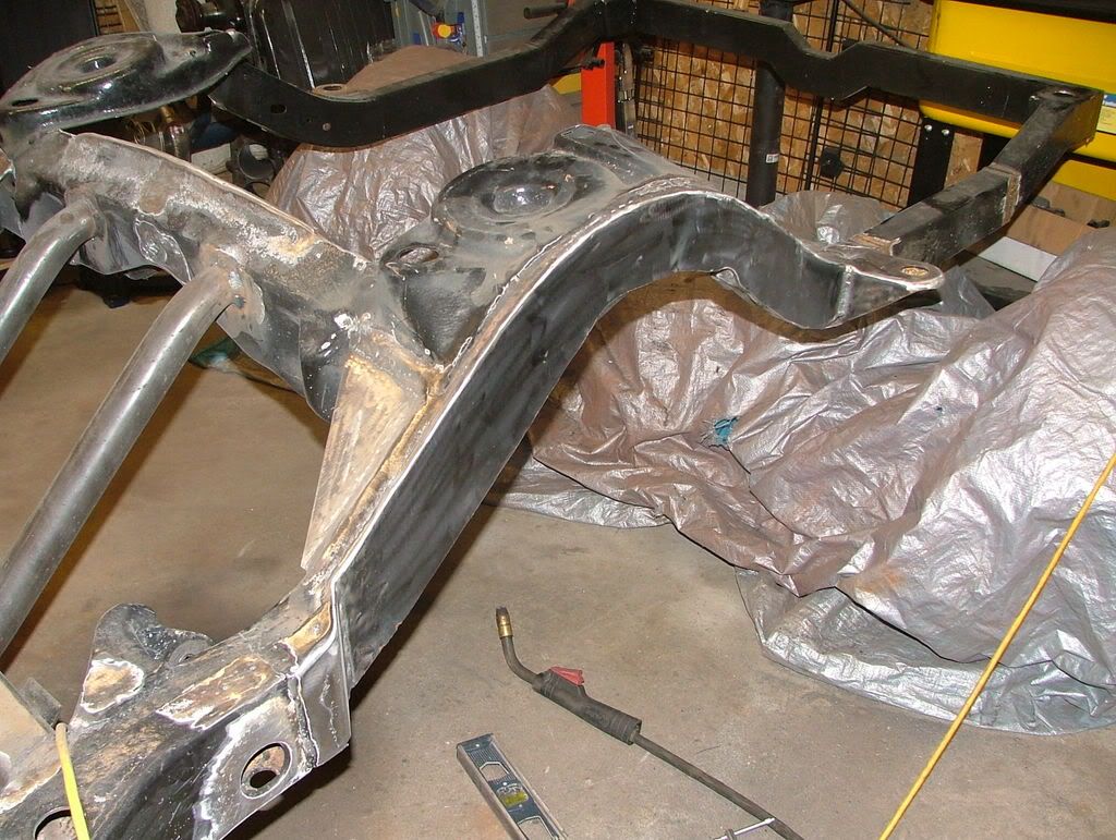

I dont know of a company that makes them but im sure they must be out there, from what i understand you have to do some pretty serious frame notching to make room..
heres some info.. http://www.chevelles.com/forums/showthread.php?t=253102
heres a pic i found of a frame after making room for the mini tub on a chevelle..
Chris
