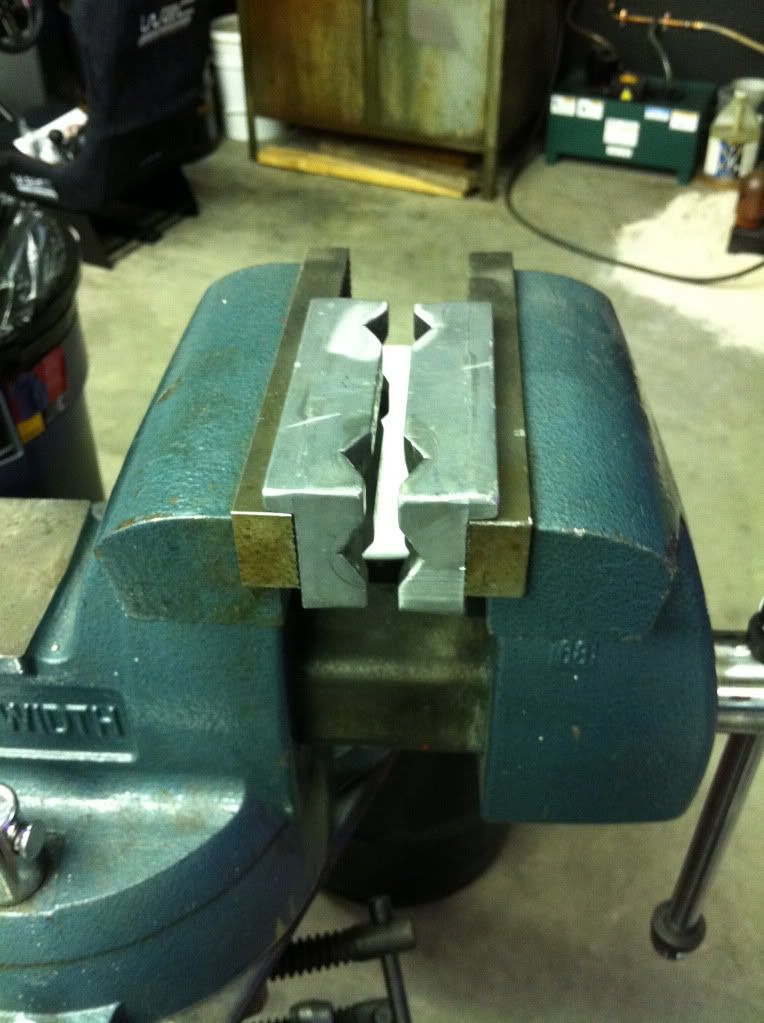

#1 Get the aluminum "jaws" for your vise. They're designed to hold the fitting while you fight with the hose etc.

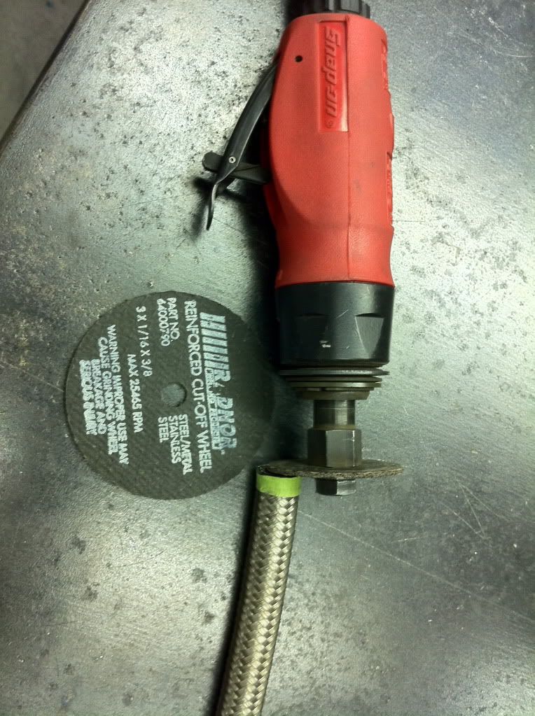

#2 Get yourself a way to cut this hose... CLEANLY

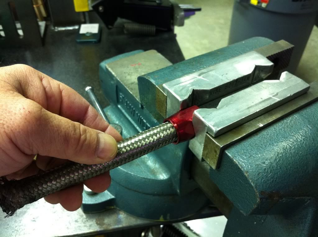

#3 Put the fitting in the jaws you bought for your vise - and insert the hose with pressure and a twisting motion. I stick the hose end in the jaws so that it's parallel with the ground so I can push and twist at the same time. Do this - with a cleanly cut hose end and it goes right in super easy.

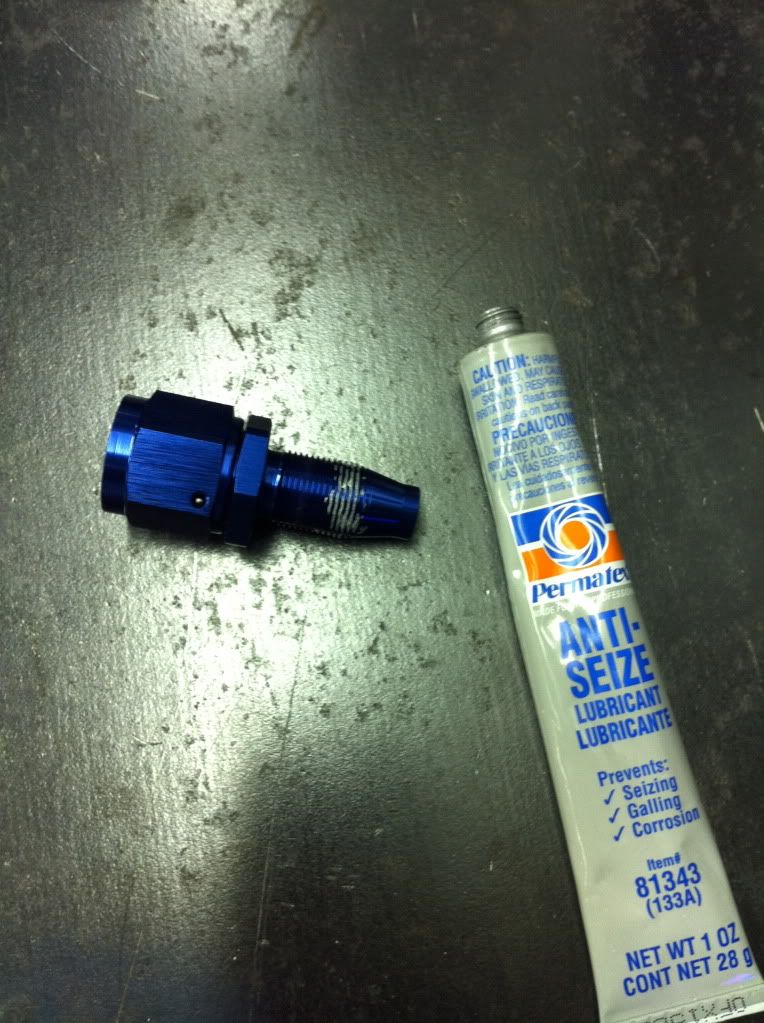

#6 Use some anti-seize on the threads of the fitting or you will gall the threads and strip them - especially if you fail on #5

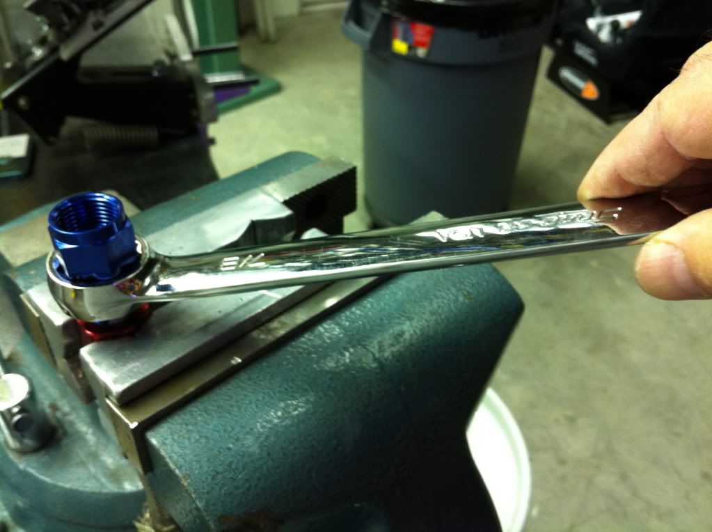

#8 Use aluminum wrenches... I use the gear drive box ends when possible to build the hose... then aluminum wrenches to attach it.
#9 When attaching the hose to whatever you're trying to plumb -- it is the SEAT that needs to fit well... not the tightness of the thread. The leaks will be because the conical seats didn't seat -- not because you haven't got the threads torqued to 900 pounds <laughing> ... When I'm installing these - I sneak up on the tightness by (after anti seizing the male thread just a dab 'll do ya) tighten - losen - tighten a bit more - losen - tighten to final. They DO not need to be tightened to 8 zillion foot pounds of torque!

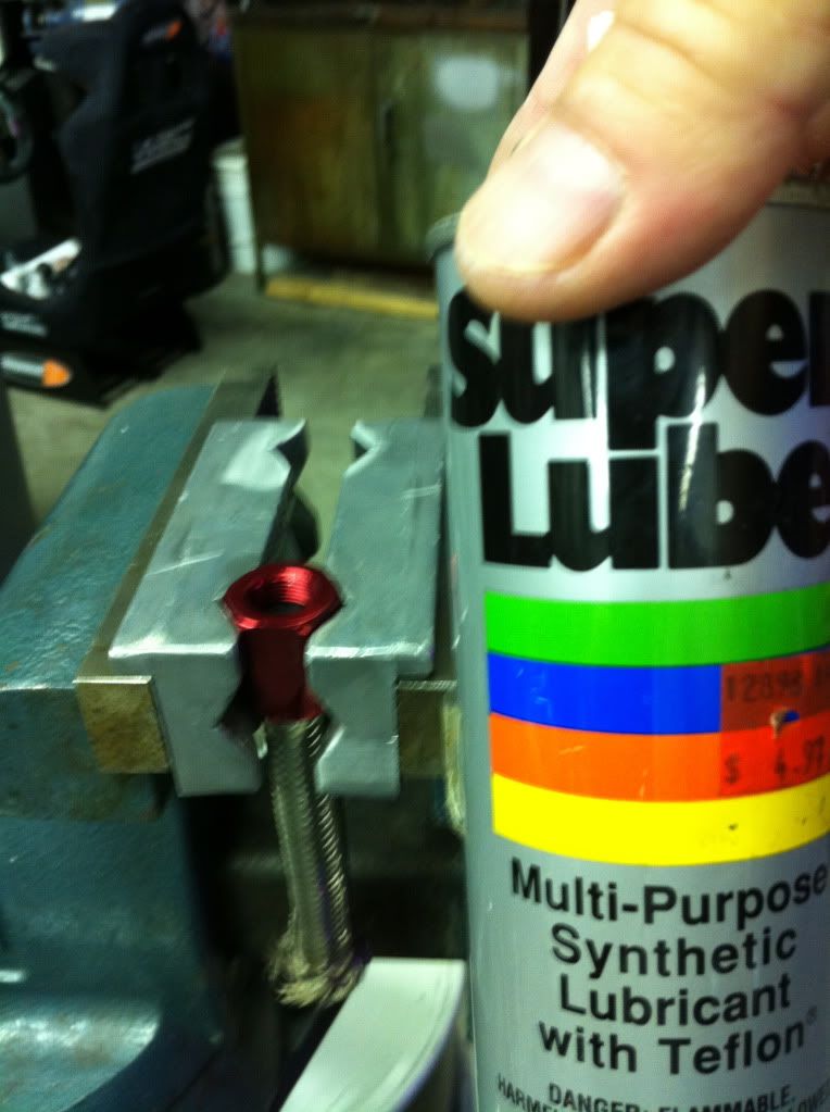

Okay here we go.....
Get yourself some Aluminum jaws for your vise!
AND some way to cut cleanly..... MOST IMPORTANT!!!!
Saw and holder from XRP....
Or giant cutters -- I hate these because they deform the hose but they do work...
Or the way MOST people do this - by taping the hose and using an air cut off saw.... USE THE THIN 1/6" blades!
Make a NICE CLEAN CUT!!
Insert the hose ferrel or whatever the heck it's called into your jaws of life...
Insert the hose with a push and TWIST..... until it seats just below the threads!

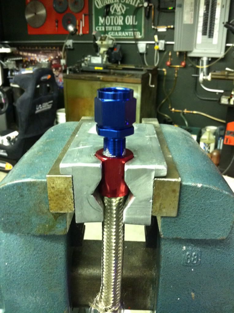

Re-install in the vise...
LUBE THE HOSE!!
Anti seize the fitting!! Don't forget this part -- aluminum GALLS real easy... and the fittings are EXPENSIVE! LOL
PUSH DOWN WHILE GETTING THREAD STARTED!
Tighten it up....
DUUUUUDE!! <spicolli style> You're done!!
