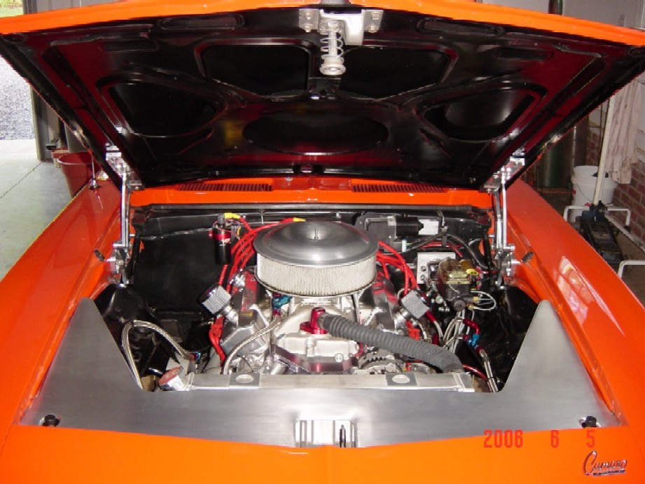

I had a piston oil groove issue. The oil ring groove on the piston was too narrow according to Weisco who custom made them. They made me a new set, switched to a Comp solid roller and got it back in. No more oil fouling the plugs and a batman smoke screen . Engine runs excellent. Made 440 hp@ 5400, 475@6400 and 442@7400. Made great torque for a 355 ci - 458 lbs @4300.

Great News Jay, another vote here for getting that thing on the road. BTW the DSE closeout and hinges look great!

Glad to hear you got things taken care of and back on the road. Looks good!! Like the addidtion of the closeout & hinges also.

Looks great and it reminds me that I need to get my billet hinges out and install them!!!
