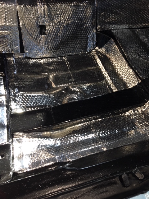

I used 1" dense foam and built it up in layers to follow the floor contours. Glued the layers together with 3M spray adhesive. A 4" grinder with a flapper disc works perfect for shaping it. Here's what mine looked like when it was done...
Wow that looks really good.

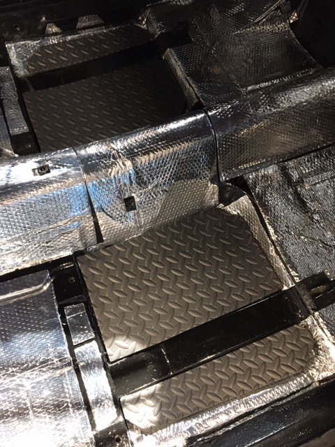

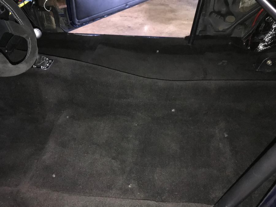

I wanted to follow up with my solution. I found some anti-fatigue mat from Northern Tool for $10. It was dense enough to accomplish what I wanted. Cheap, simple, effective.
