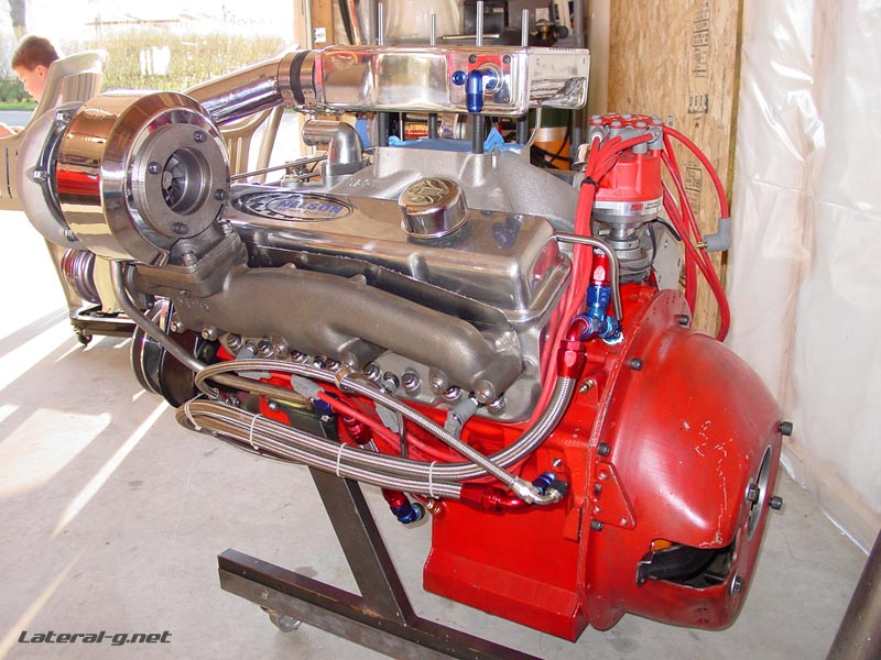

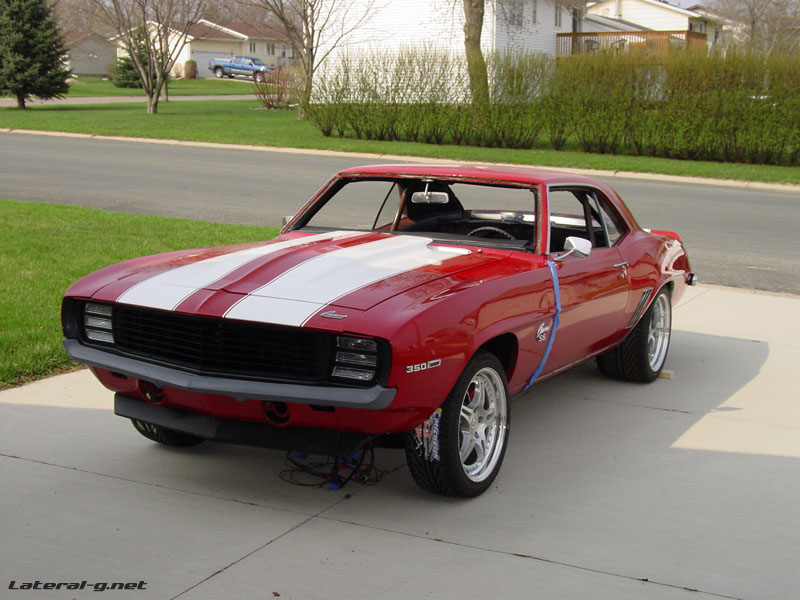

Here's a few updates on my project. The front clip is just mocked up so I can test the fit of the RS buckets and weld in the tabs on the fenders.

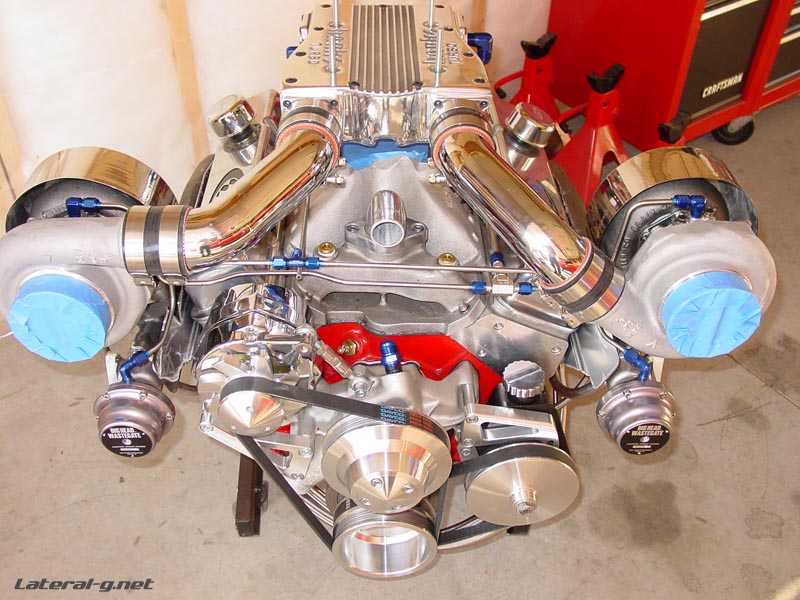

I have all the oil feed and return lines and wastegate lines bent, I'm just waiting for a -10 to -6 adapter for the T at the back of the block as well as an AN flare tool (37* flare) and that part is done. Next week, the intake will be on its way to Force-EFI to have the injector bungs welded in.

that thing looks incredible. The Banks twin turbo is awesome addition. Are you going to make the power tour this year?
