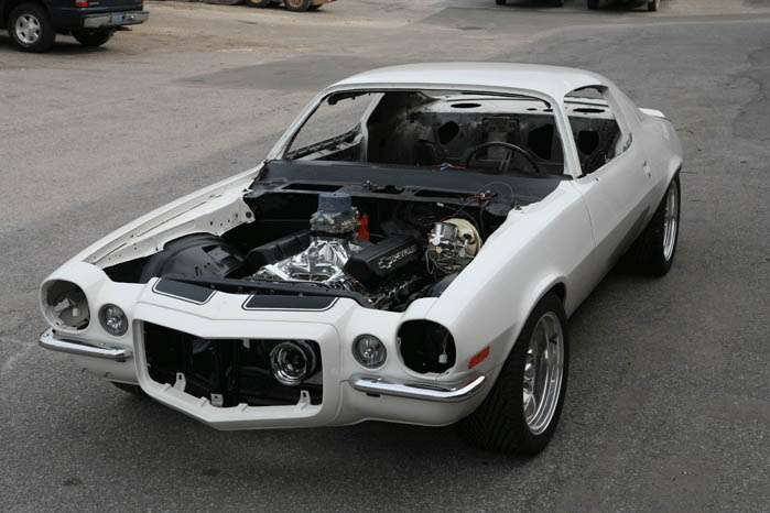

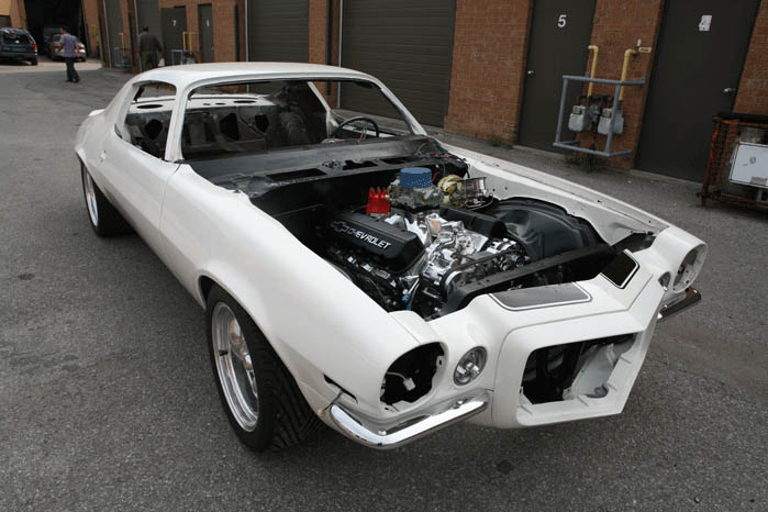

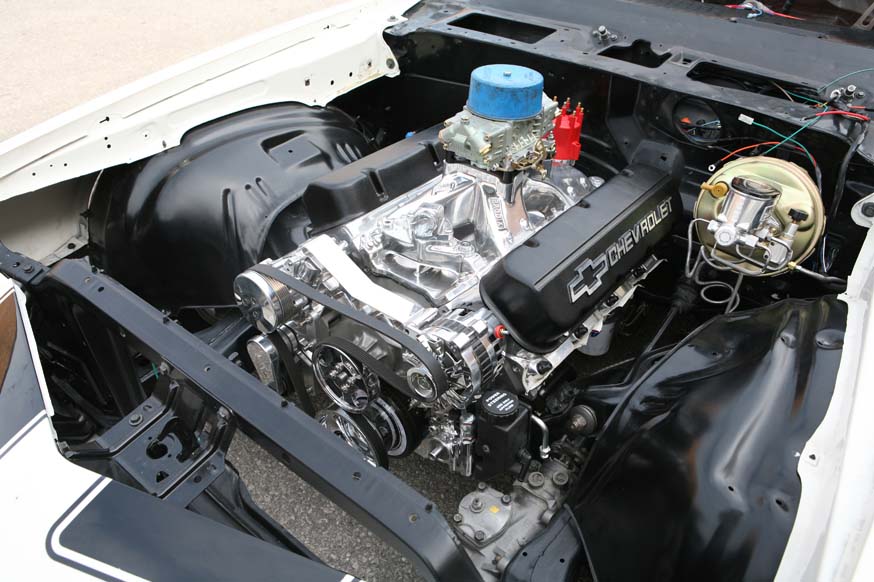

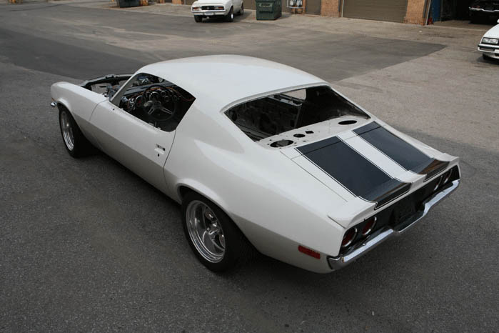

We tried some Headman big tubes and lost a month to delivery, rejection and booking/scheduling in at the custom fabricators shop (note the guys at Headman were very helpful,,,just did have the right product for this application as it turned out).....Following that our desire to step headers and the later decision to move the engine down roughly 2 inches and back two inches completely eliminated the Headman option (note update pic's taken prior to the motor move)....After discussing the drive line with the spring manufacture it was determined that a Carbon fiber mono spring to fit the applications space constraints wouldn't work out....We opted for a steel mono spring application with adjustable QA1 shocks on the rear.
We hope to get back at it again in the next few weeks ,,,,looks like spring 2009 is going to be a lot of fun all things equal (LOL... famous last words LOL)...
Okay so how close is the oil pan to the ground
We've dropped the suspension/nose roughly 2+" from stock and the oil pan is a custom built/spec Steph's pan that has it's lowest point line up with the bottom of the stock sub-frame cross member......I don't recall the exact height from the pan to the street to be frank.......You'd have to do some serious bump stopping/bottoming out on the sub-frame cross member and scatter shield lip prior to hitting the lowest point on the pan after "all the suspension/motor mounts adjustments" have been taken into consideration......
