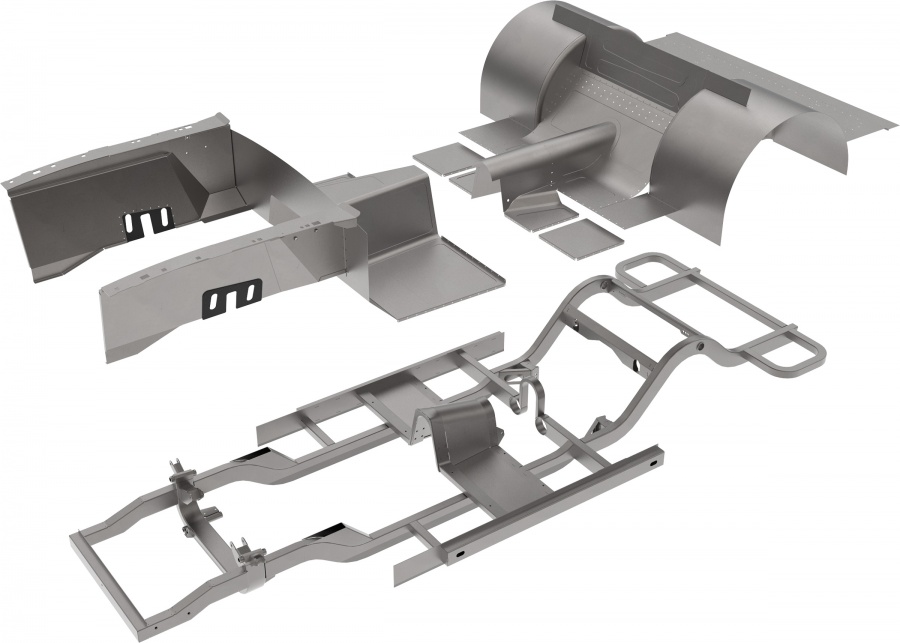

Schwartz Performance chassis are designed to be a bolt in deal. They look better than stock and you just slap your body on and you’re done. But with modern transmissions you’re more than likely raising up the transmission hump. Then with the lowered stances we all want, you’re more than likely reworking the drive shaft tunnel as well.
Lino explained the train of thought behind Chris Alston’s Chassisworks chassis. “Chris Alston’s Chassisworks has a long history in drag racing and with that comes a different approach to a replacement chassis. For decades drag racers have been cutting away the frames and floors in the pursuit of speed and greater reliability. By taking this approach, Chassisworks was free to design a frame and floor structure suitable for four-figure horsepower builds and the largest street tires currently in production. Without restriction of the stock rear floor, multiple styles of suspension can be used, including canted 4-link, torque arm with Watts link, IRS and parallel 4-link or ladder bar if you’re wanting to go pro street.”
Chris Alston Chassisworks Chassis
For Chris Alston’s complete chassis set ups, they require you cut the entire floor out of the car. His thinking is that by time you make transmission hump modifications, driveshaft tunnel modifications and rust repair, you’re over halfway to a completely new floor. So instead of trying to put a completely new suspension under a car and make it work with the factory floor, they just remove all the stock floor and put in new. This made a lot of sense to us, but definitely not everybody’s cup of tea either.
