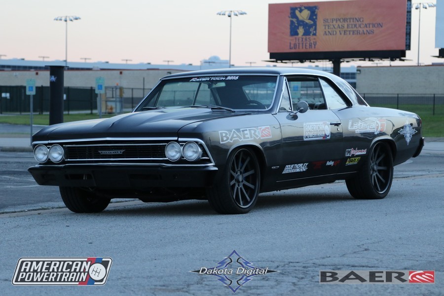

Parked at the Texas Motor Speedway
For the last few days I have been thinking about the Power Tour, trying to wrap my head around the whirlwind of cars, horsepower and crazy amount of miles. I didn’t set any records for the most miles driven by any means, but for this car it was quite the accomplishment.

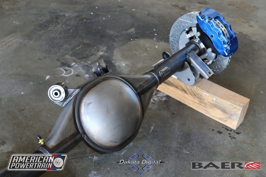

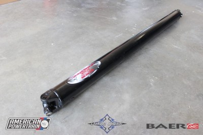

When I was building this car the last few months, I was focused on all the big items. Making sure I ordered all the correct parts from Holley to get the engine assembled. But then I needed a new clutch, which I ordered up from American Powertrain, along with their cross member to get the engine sitting correctly. All easy stuff – until I realized now I’ll need a different driveshaft since the engine and trans sat in a different position from the old set up. Freaking out, I ran over to Inland Empire Driveline. In a bit of a panic I explained to Jeff Gilroy what I needed, which was basically a new driveshaft. Since I had upgraded to the new Currie 9″ rearend, the rear yolk was bigger so the old U-Joints won’t work. Then the driveshaft itself was too short and needed to be extended. Jeff explained that really meant that they could only reuse the front yolk and that was about it. Without fail though, a few days later they had a brand new driveshaft waiting for me that fit perfect.
The new Currie 9" and Baer brakes - a winning combination!
The new Currie 9″ and Baer brakes – a winning combination!

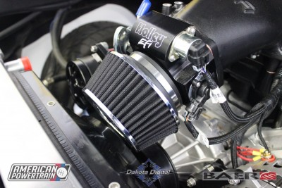

Even little details were starting to slip or taken for granted. Something as simple as an air filter. I thought that would be the least of my worries – just grab a filter, slap it on, and go. Well after installing the Flex-A-Lite radiator and the Holley Mid-Rise intake, there was hardly any room left! Again I called in a panic over to Spectre Performance. Mike over there assured me it wasn’t an issue, and had an air filter that would fit the very next day for me. I breathed a sigh of relief seeing it slide on the throttle body and fit like it was supposed to.

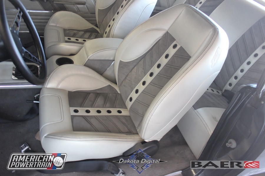

These seats saved my ass, literally!
These TMI Products’ seats saved my ass, literally!
I started to dread sitting in the car for over 4,000 miles at one point as well. A few years back I was working for TMI Products, and we installed a set of their Sport-R foam and upholstery on the stock GM Strato-bucket seats. This was a massive improvement over stock, offering more bolstering and a more comfy ride. At the end of the day though, they were still a 50 year old seat. I wanted something that slid back further, and reclined. I remember at SEMA they were releasing their own universal seats, so I gave them a call. Shortly after I had a set of their new Pro-Series seat, which is a completely new seat they make in-house. This version is a low-back – they offer a high-back version as well. The seats sit lower in the car, slide back way further, and recline! I was ecstatic. The best part was they used the same material I already had in the car so it matched the rest of the interior. I can say that after putting 4300 miles in the seats, they are still super comfortable and were one thing that made the drive enjoyable and comfortable. Going around corners I was still held in place nicely though.

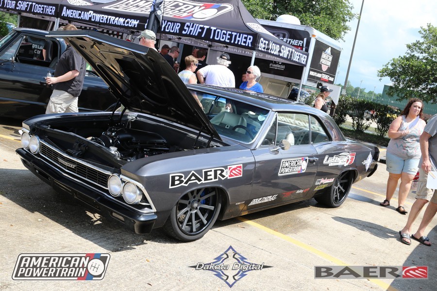

Finally parked in Gonzales, LA for the first stop!
Even blasting across the entire width of Texas, fully loaded, AC cranked and averaging about 80 MPH, the car averaged 17 MPG. Not bad for a 416 cubic-inch LS3 that should be in the 600 HP range. The only issues we encountered was a fender bolt that came loose, which mean the passenger front fender rattled a little bit on big bumps. The nut that holds one of the rear shocks to the rearend also came off so we drove through half of Texas with a little bit bouncy rear. Both things that were easily fixed the next morning.
