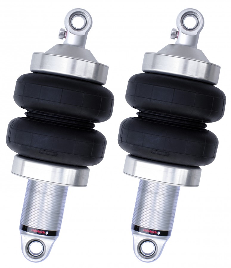

The same adjustments are needed on air bag set ups as well.
