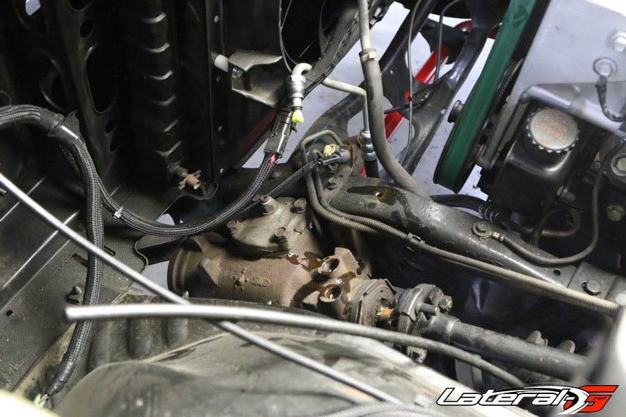

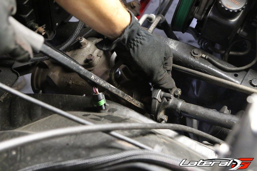

Since this box is a direct replacement for the stock box, installation is incredibly easy. We started by removing the pitman arm, then popping the rag joint off the box. With the slip shaft, we were able to slide it up out of the way.

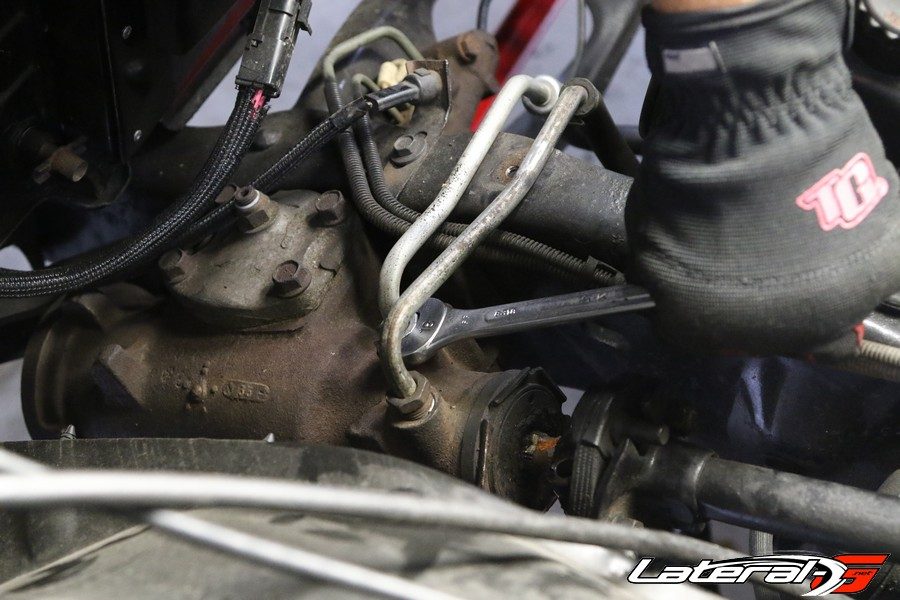

We then removed the bolt holding the power steering lines from the frame and then popped the lines out. One quick trick we learned in order to avoid spilling power steering fluid all over is to grab a set of foam earplugs. Roll them up like you would to put in your ears and shove them in the lines. Once the expand they do a great job of holding back the fluid from making a mess everywhere. The last step was to unbolt the box from the frame and get it out of the way.

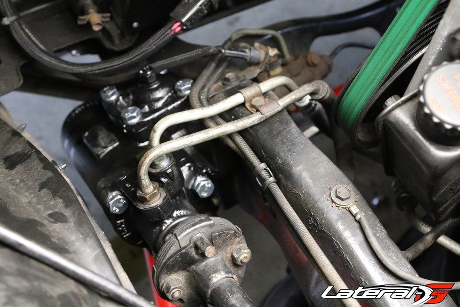

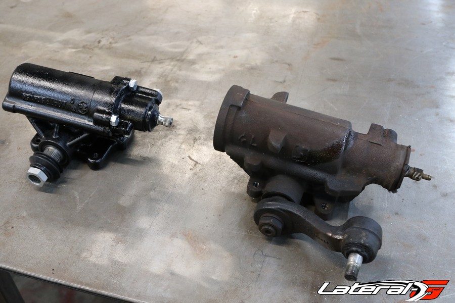

Laying the old box and the new box side by side, the new box is actually a little bit smaller that the original but has more reinforcements built in for a stronger box. After bolting it into the frame we simply reversed our steps till we had everything reinstalled. The total time to install this box was roughly an hour as we took our time and snapped pictures.
