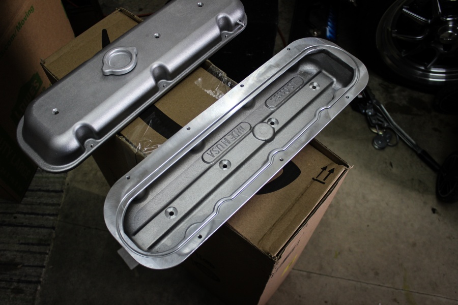

They offer a few different LS valve covers. For starters they offer a cast BBC valve cover or a chrome version. They offer a cast or chrome 409 valve covers and they offer a finned version. We opted for the cast BBC because we wanted to paint them orange to match the rest of the engine.

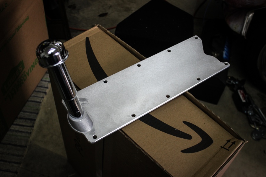

One other trick piece we picked up while we were at it is a new valley plate that has a fill tube machined into it. Not only will this help make oil changes easier, but the oil fill tube includes a functional breather cap has a classic small-block look that will help complete the look for us. If the fill tube isn’t your thing, Lokar also offers the valley plates without the oil fill but with a high efficiency integrated breather assembly.

With everything aside we unbolted the factory valley plate and set the plate and bolts off to the side. Then we slid the new valley plate into place and used the supplied allen head bolts to tighten it down. Then we reinstalled the intake, fuel rails and wiring.

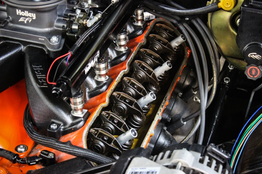

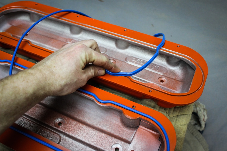

On the valve covers we popped off the SBC covers and adapters out of the way. The new Lokar BBC valve covers are unique in that they bolt directly to the LS heads and they do not need an extra adapter that would add to the height (the Lokar covers are only 2” tall) and could leak. The covers use a factory LS gasket, so we picked up a brand new set from NAPA on our way home the other day. The new gaskets simply push into the valve covers like a factory set of LS valve covers. Before going further we installed the faux outer mounting bolts and load spreaders just like a real BBC valve cover would use.

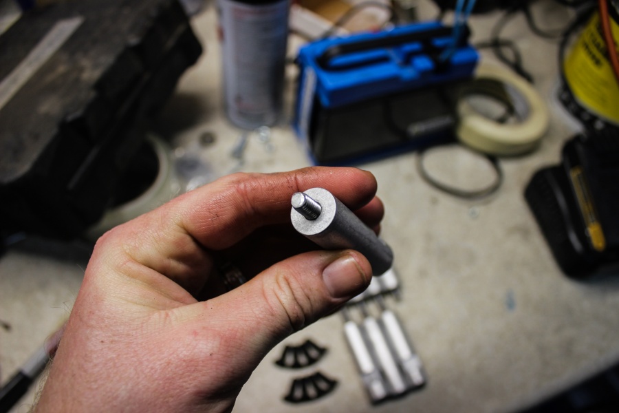

In order to install these new valve covers we have to install a set of spacers. These spacers are supplied by Lokar and pretty trick pieces. On one side they have a stud sticking out, then on the other side they are threaded. A supplied O-Ring pops into the threaded side in order to seal up the mounting bolts.
We took these spacers and screwed them into the heads where the factory valve cover bolts would normally thread. These spacers are machined to accept a wrench so snugging them down is easy.
