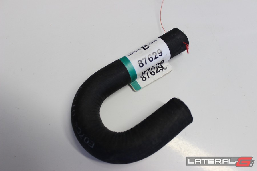

There didn’t seem to be a definite answer, so we figured we’d just run a hose to be safe. The problem is if you use a regular piece of heater hose it will kink and impede water flow, plus the fittings are two different sizes.
Luckily there’s a super easy answer. For about $10 at Autozone, we found this hose, in stock. Not sure what it’s off of, but it works perfectly after being trimmed down.
The part number on it is B87629, and here’s a link to it on Autozone’s website. Another reference number we found is #4354, which is what we used to find the hose. The person had to cross reference it, but still found it.
