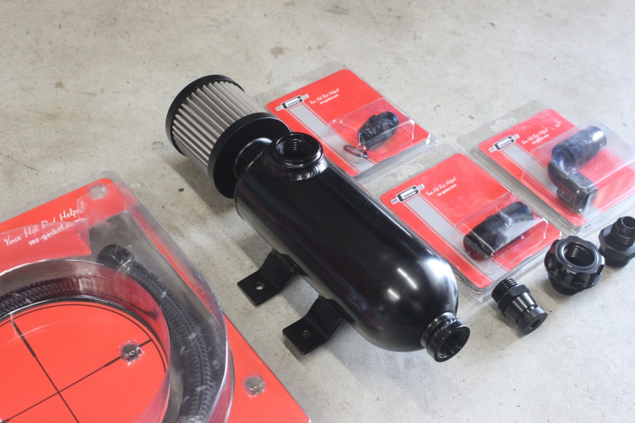

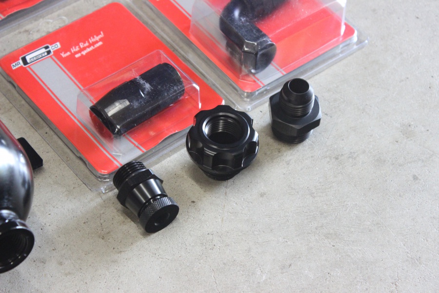

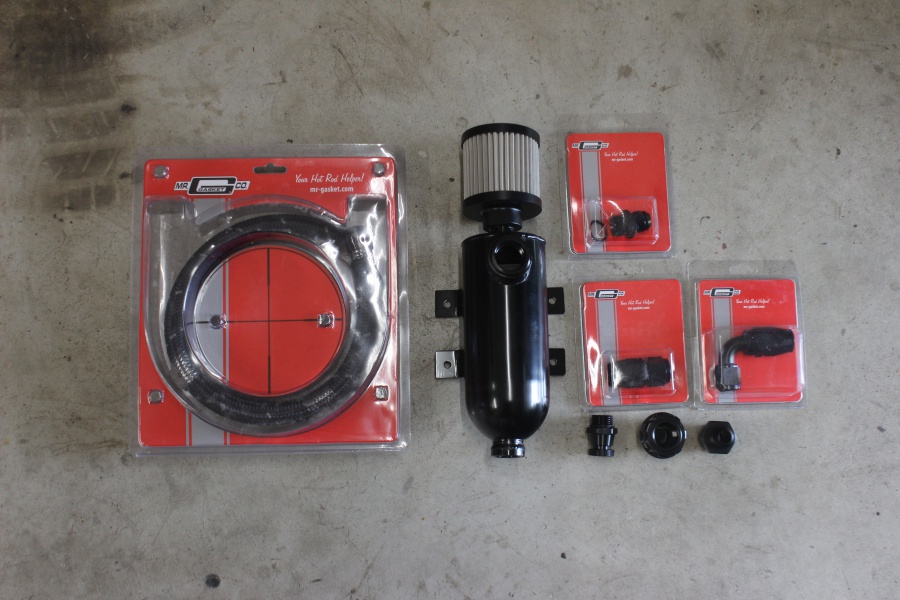

Holley in their infinite wisdom saw how many people were boosting these LS engines and came up with a solution. This kit works with the very popular LS Valve covers they offer where it converts the oil fill cap to a -10 AN fitting. The kit includes this adapter, along with all the other fittings, a breather tank and three feet of AN hose.

Our first step was to remove the existing catch can we had on the engine. This was pretty simple, just required us to pull the hoses off the manifold and valve cover, then cap those. We had the catch can mounted with self tapping screw to the inner fender, so we popped those off as well.

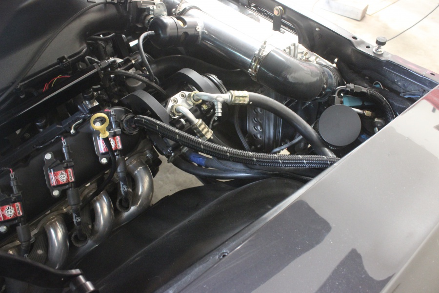

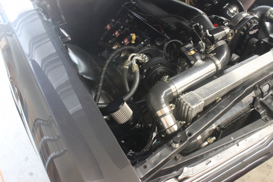

The hardest part was going to be mounting the breather tank. It’s larger than our original catch can and there isn’t much real estate available under the hood. What we ended up doing was reusing the bracket we fabricated for the catch can and slightly bent it. This allowed the breather tank to mount in the same position, but at a slight angle. Ideally it should be mounted vertically, but there just wasn’t space to do so.

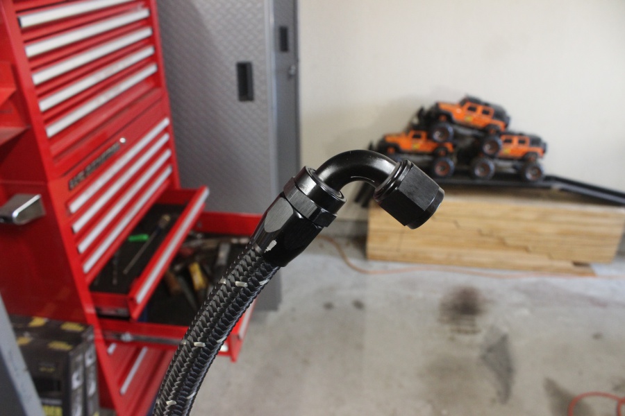

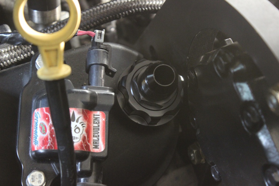

With the tank installed, we popped the fill cap off, and screwed in the Earl’s oil fill cap with built in PCV Vent. Then we attached the AN fittings to the hoses, and routed the hose from the valve cover over to the breather tank.
