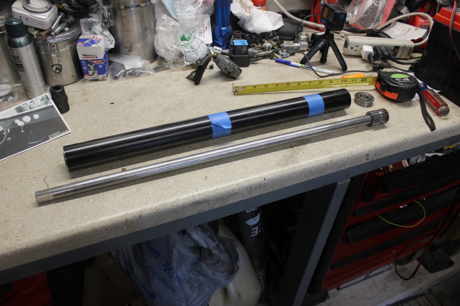

Steering Column Shortening
We started with the steering column first. The first order of business was to disassemble it and see what we were working with. The column was really basic as there’s no electronics or tilt mechanism. There’s a shift that runs through a tube with bearings on either end. After popping everything apart, we cut down the tube about 8″. The inner shaft we then cut 8″, but the end needed a Double-D on it to properly slide into the coupler. After a little grinding we had a nice snug fit. With everything back together the column was much better ergonomically.

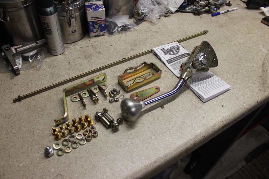

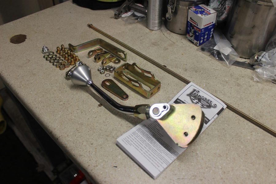

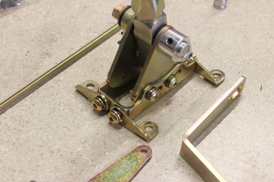

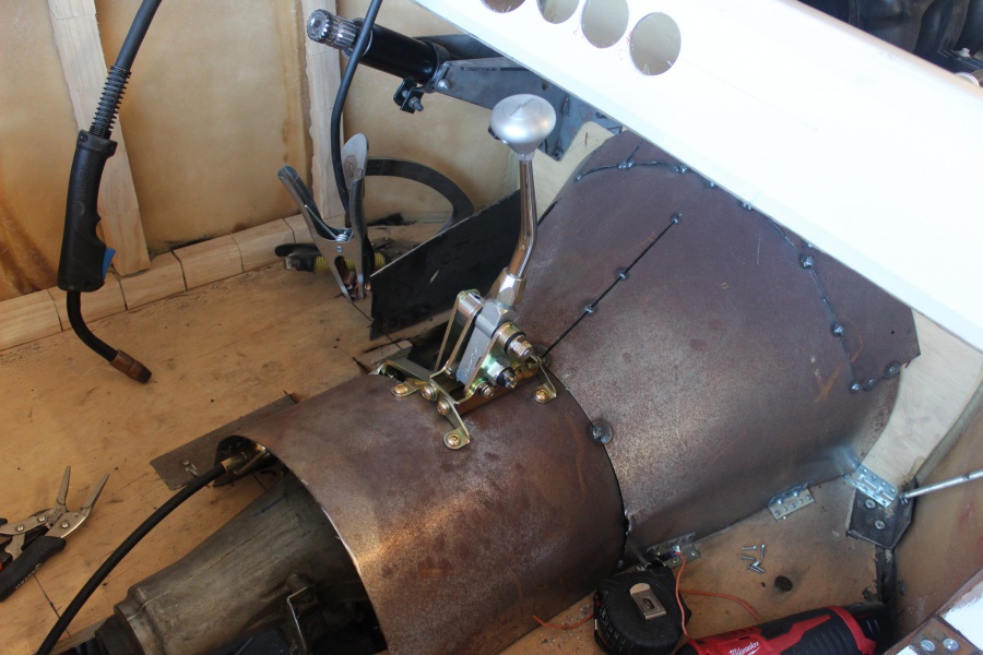

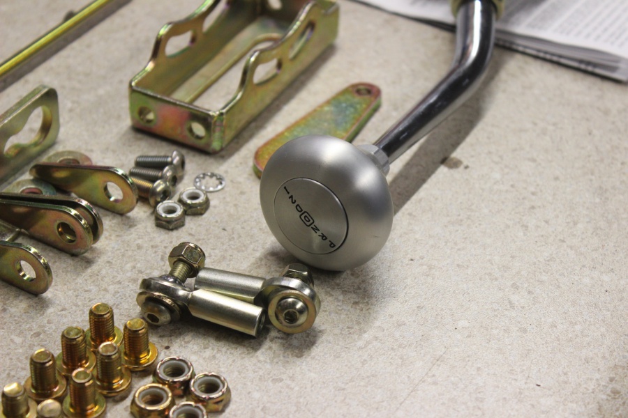

From here we wanted to tackle the shifter. We picked up a Lokar shifter to use as we had such great success with them in the past. They have endless options for handle lengths, shapes, and knob shapes. We went for a basic one since this car isn’t too fancy. Our first order of business was to get the shifter itself mounted to the transmission tunnel.
After attaching the four wings to the base of the shifter, we set it on the floor. Before bolting it down we wanted to cut the slot for the arm that hangs off the shifter. After cutting the slot it became pretty apparent that we were going to have to do some more cutting. The tunnel we tried to keep as close to the transmission as possible so that we’d have maximum clearance in this tiny car. We decided to just cut the drivers half up and rework it once we got the shifter in place.

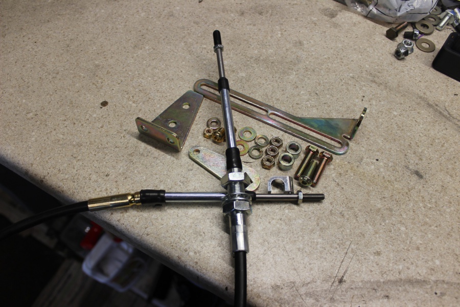

Then we realize that this shifter with the threaded rod wasn’t going to work. The neutral safety switch is in the way and once switching into gear the arm on the trans would hit. We started brainstorming a bit and actually reading the instructions and saw that Lokar offers a cable to use instead of the rod. We ordered one up and a few days later it arrived and we went straight to work.

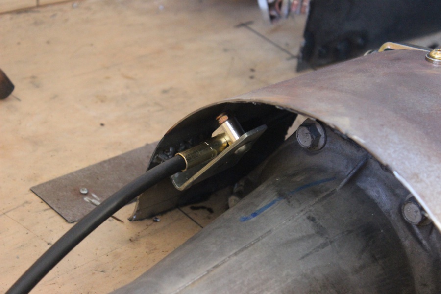

On the shifter side there’s a bracket that has to be mounted to the trans hump that holds the cable, then the cable goes and attaches to the arm on the shifter. We didn’t have the room to really bolt this into place, so we ended up grabbing our Miller welder and welding it to the trans hump. With that end finished, we moved to the transmission side.
This side uses a bracket to hold the cable that bolts to the transmission using two transmission pan bolts. We loosely bolted it up and then installed the new arm on the transmission – then connected the cable. After a few adjustments we tightened everything down and the shifter was in business! Our last step here was to weld the transmission hump back up giving the shifter plenty of clearance but also trying to give the driver plenty of room.

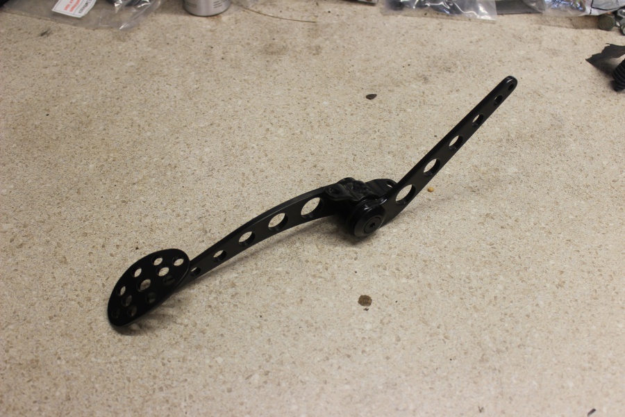

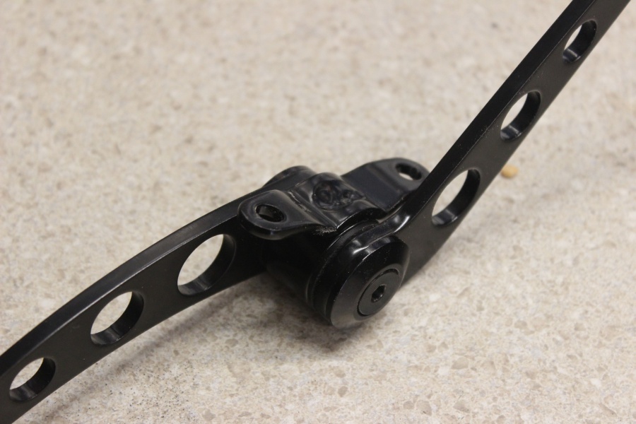

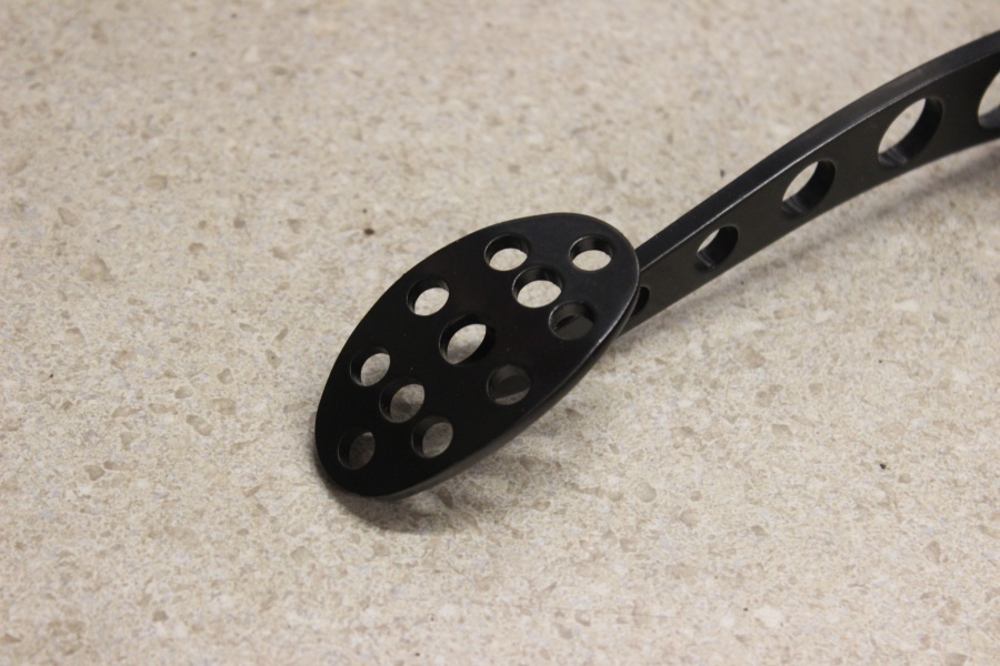

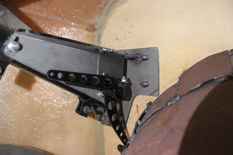

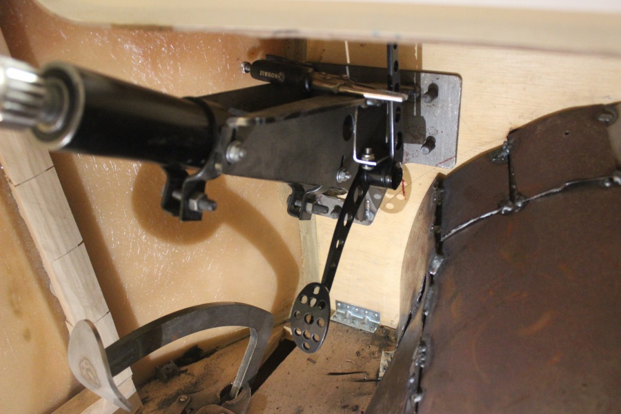

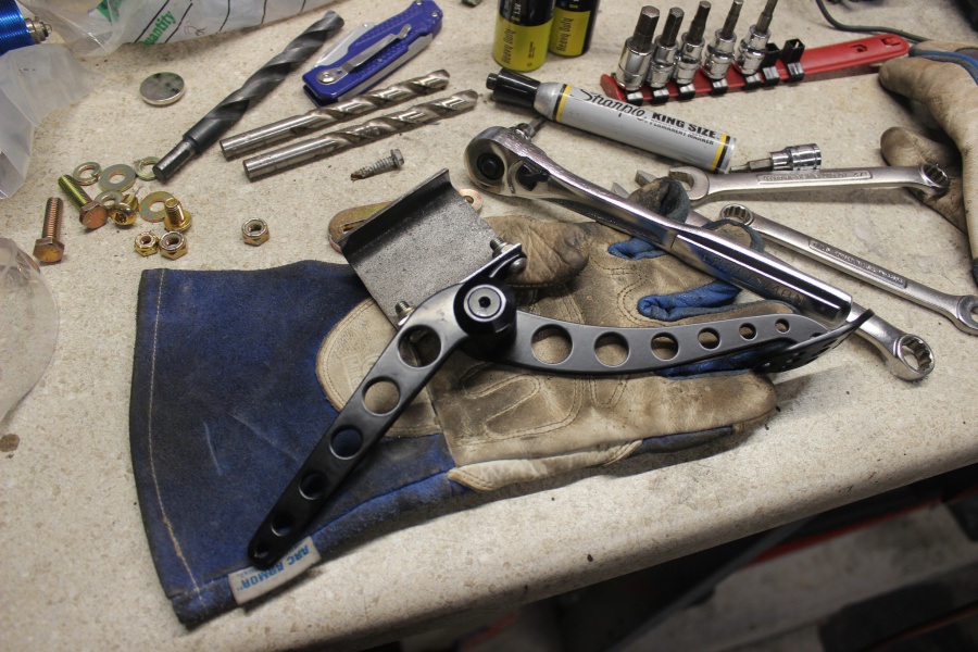

The last thing to install was a Lokar Lakester gas pedal assembly. These are two arms that are splined together at the pivot so you’re able to move to the arms to the perfect location. After looking under the dash it became apparent that the easiest spot was to mount it to the steering column bracket. If we did that though, the pedal pad would be quite a bit higher than the brake pedal pad.
Looking around we saw a piece of rectangular tubing and we cut a piece out of it to give us a ‘C-Channel’ that’s 1.5″ tall, which will drop this assembly down. A few holes and the extension was bolted to the pedal. With the welder sitting there from our other repairs we welded the ‘C-Channel’ piece to the steering column bracket.
Just like that over the course of a weekend or less, we had a proper steering column, shifter, and gas pedal! We did order up a Lokar throttle cable, but have to wait to install that until we figure out the bracket to hold it on the intake – so check back for more updates!
