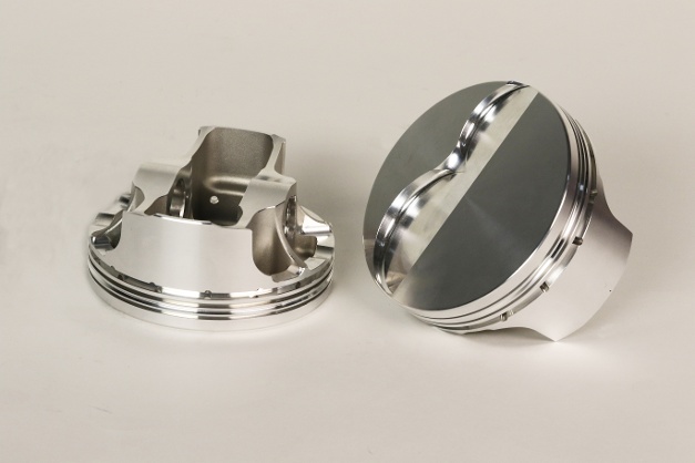

Just as the correct piston will help resolve issues of compression and rod-length ratio, a properly designed stroker piston will also remain secure inside a production cylinder block.
“JE offers piston solutions for 3.622, 3.900, 4.000, and 4.100 stroke cranks as off-the-shelf catalog options with 6.125-inch rods,” says DiBlasi. “Additionally, JE can make a custom in any combination that our customers would like. We do make recommendations on what works best based on engine configurations, our dyno-testing and race-winning solutions.”
According to JE testing and calculations, the 3.900-inch stroker crank is the most practical for the LS engine when balancing power and durability.“It gives enough of a displacement increase to make most people happy, and is substantially more stable in the cylinder bores in comparison to 4.000-inch and larger strokes,” explains DiBlasi.

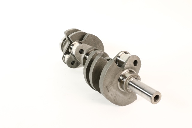

This crankshaft has a 4-inch stroke. While the 4-inch stroke is one of the most popular stroker cranks for the LS engine series, it often causes the piston skirt to pull out of the bottom of the bore at BDC promoting accelerated wear. A 3.900-stroke provides a similiar displacement increase with better wear life for a street car.

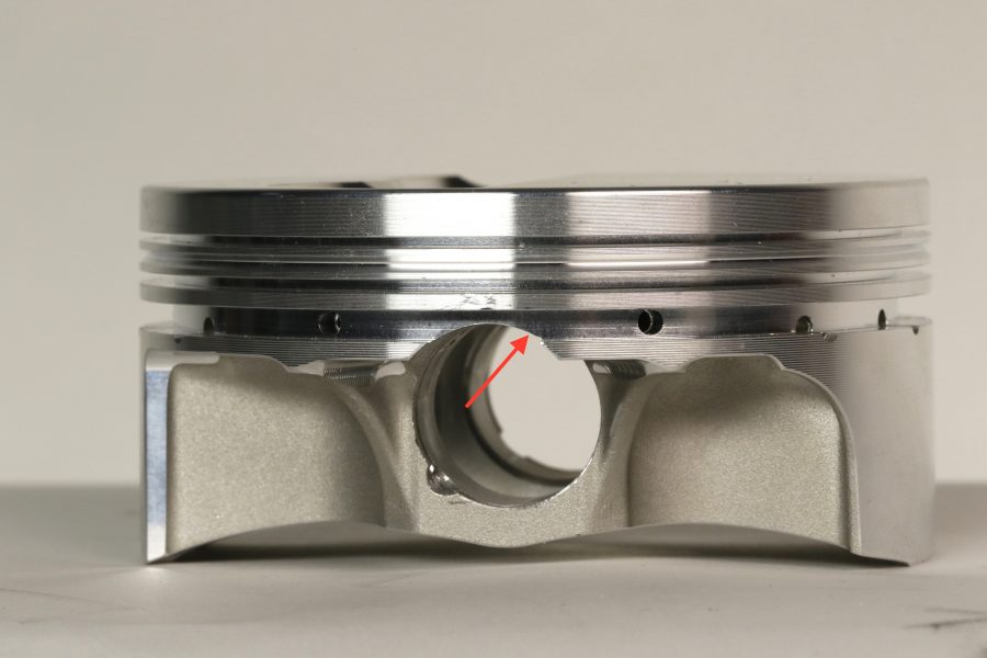

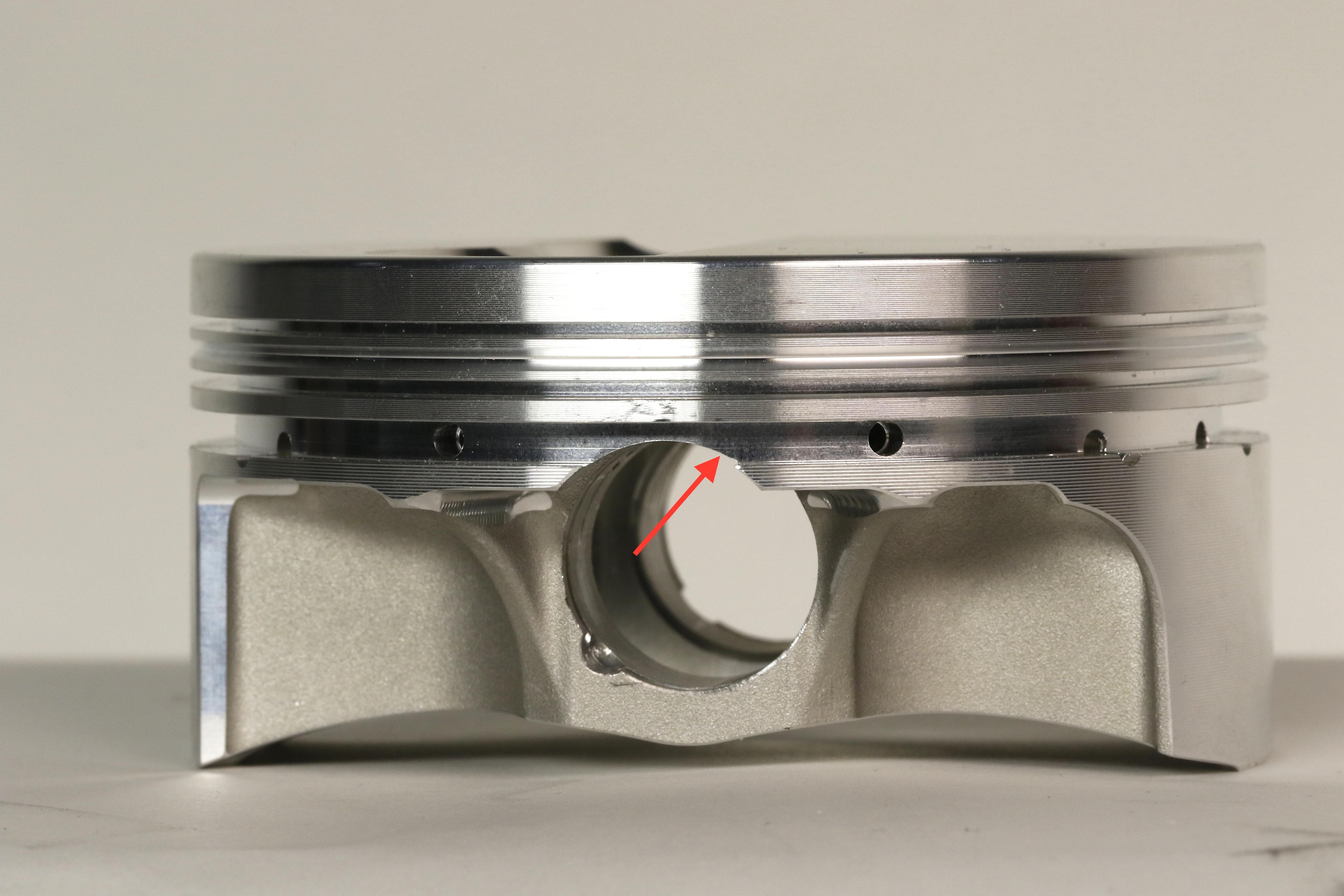

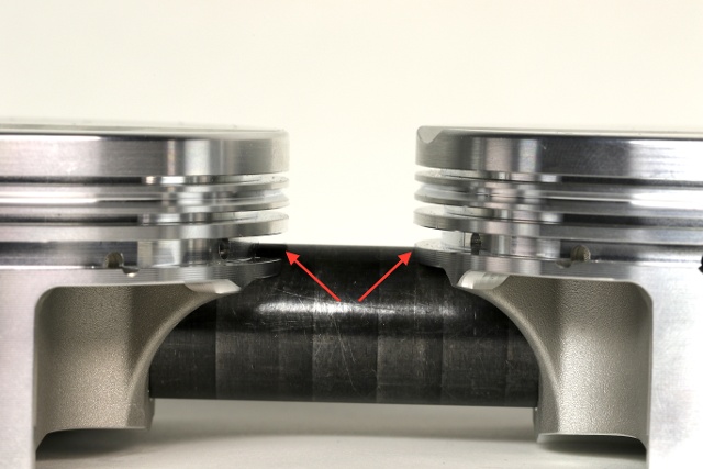

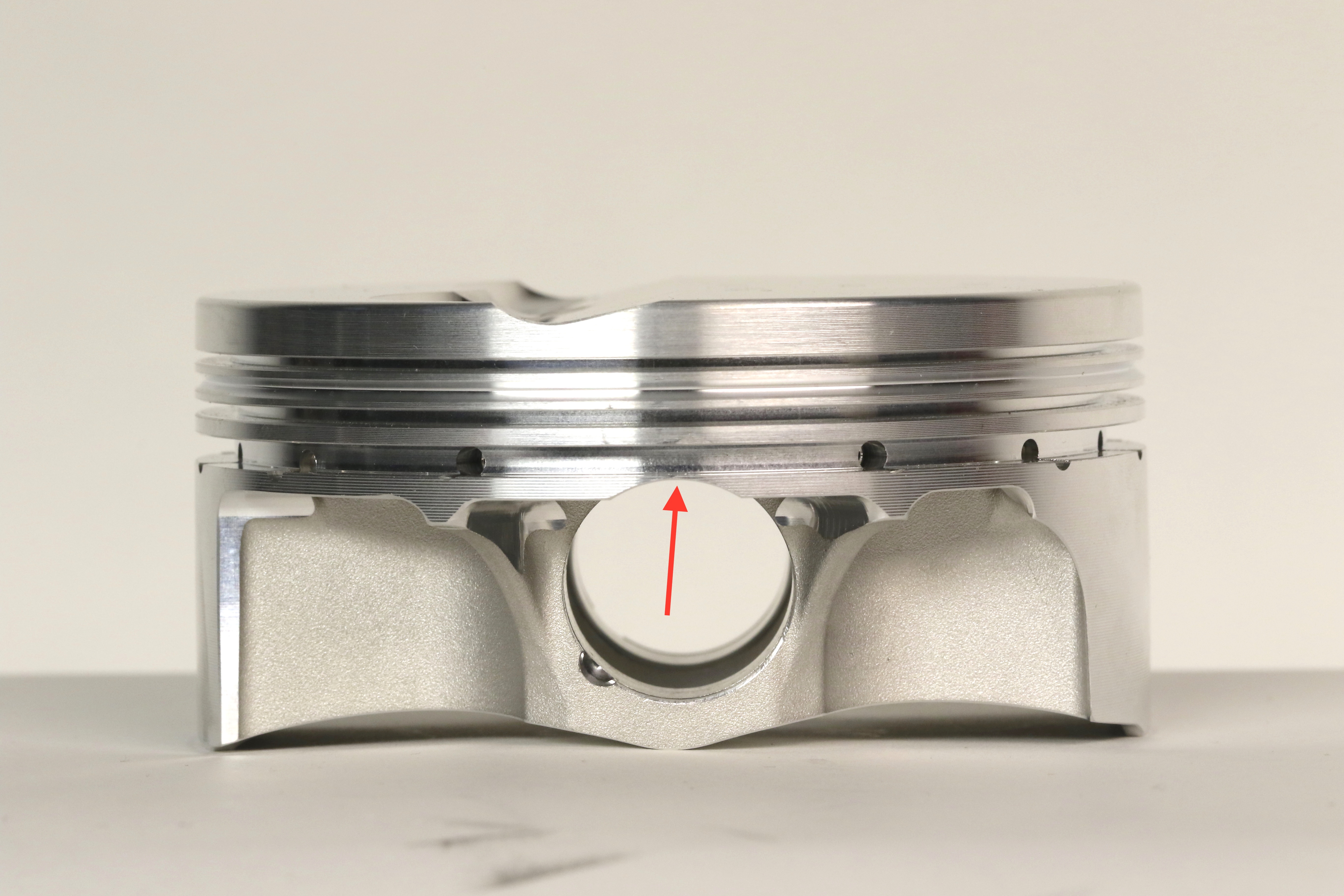

So, it’s up to the piston manufacturer to make up the difference by moving the location of the wrist pin—which is called the pin or compression height—closer to the top of the piston. There are obvious limitations to how short the pin height can be engineered because of the ring locations.
“The pin height/compression distance is a factor based on the stroke, rod length, and deck height,” confirms DiBlasi. “The piston height is directly related to those items.”
With a large increase in stroke length, the piston manufacturer also has options in skirt design to help minimize if not avoid exposing that skirt at BDC.
“The biggest issue is that the skirt sees excessive wear when pulling out of the bottom of the skirt. Since the piston is unsupported it is now able to rock side-to-side more,” explains DiBlasi. “That additional rocking puts wear on the exposed skirt that pulls out of the cylinder.”

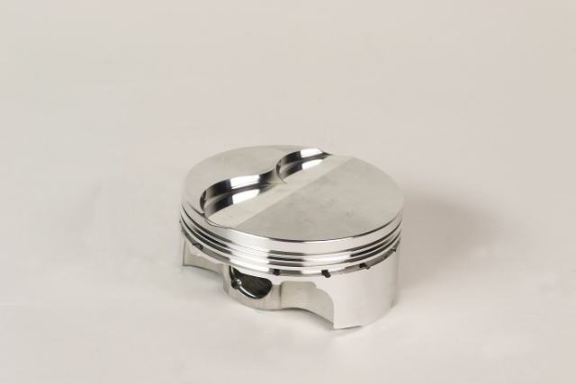

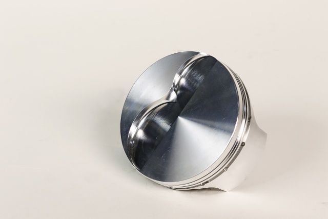

“With the larger stroke cranks, our pistons have to have a skirt clearance that clears the counterweights of the cranks. All our pistons are designed specifically with each crankshaft stroke and rod combination in mind,” says DiBlasi. “The compression height, piston volume, skirt and thickness below the pin on a 4.100-inch stroke piston versus a 3.622-inch OEM stroke piston will be different to accommodate this.”
