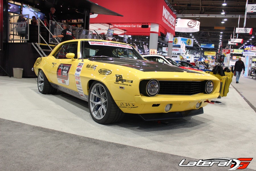

First up is Mark Stielow. He’s built a half dozen first-gen Camaros, each more bad ass than the previous. When asking him he told us that “hands down the 1967 to 1969 Camaros are the best, followed by the 1970-1973 Camaros and Firebirds.”
“ As for the third place car that is tough – I think it is the Chevelles.  I base this on availability of parts and resale value. I think the Mustangs will come along but they are a little like Corvettes where there is a bigger community that wants to keep them stock. The Camaros and Chevelles are more of a mix.”

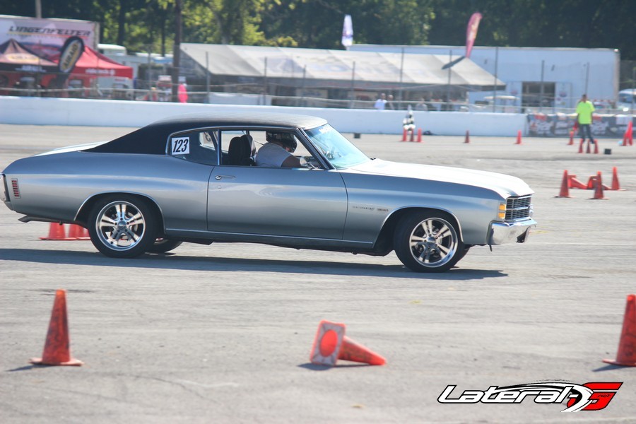

  • 64-72 GM A body – Chevelles and their Buick, Oldsmobile, and Pontiac derivatives. They’ll swallow any drivetrain with ease, the suspension responds nicely to simple bolt-on modifications, and they’re available everywhere. In addition to being supremely comfortable to drive, every restoration and performance component imaginable is available. These cars are not overly prone to rust and base models are available cheap.

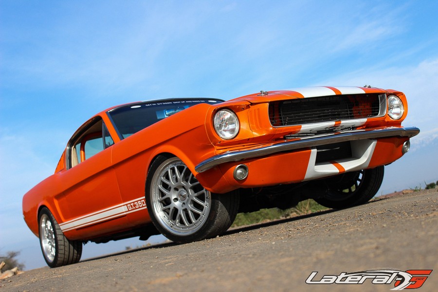

Mario De Leon Mustang TMI Products Lateral G Pro Touring 04
The Fundamentals:
  • Weight – Lighter cars perform better in every genre
  • Wheelbase – Shorter wheelbase cars turn easier on Autocross course and longer wheelbase cars provide more high speed stability on road courses
  • Trackwidth – Wider track widths increase cornering speed capability, but too wide can be an issue on some super tight autocross courses
  • Aero shape – Matters more on road courses and less on autocross
By Planned Usage & Goals, Separated by Build Type
1.  Street & Autocross Only
a.  Bolt-ons to stock frame/clip
Good: 69-70 Mustang, 70+ GM F-Body. Better platform would be the 1965-1968 Mustangs or 1967-1969 GM F-body platform. The best would be a Shelby Cobra or C2/C3 Corvette.
b.  Replacement of frame/clips and therefore complete suspension
Good: 1969 or 1970 Mustang, 1970+ GM F-Body. Better platform would be the 1965-1968 Mustangs or 1967-1969 GM F-body platform. The best would be a Shelby Cobra or C2/C3 Corvette.
c.  Ground up build with custom frame, cage, floor, suspension, etc…i.e. “Race Car with License Plates”
Good: 69-70 Mustang, 70+ GM F-Body. Better platform would be the 1965-1968 Mustangs or 1967-1969 GM F-body platform. The best would be a Shelby Cobra or GM H-Body(Vega/Monza).

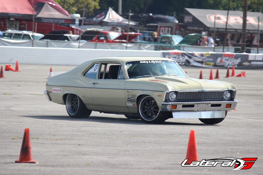

“That said and done, my project car would be a mid-year (1960’s) Chevy Nova or Chevy II, a two-door naturally, and as you can still find good, solid examples lurking in back yards, garages, and at car shows, a savvy shopper can still find one at a reasonable price,” explained Pozzi.
