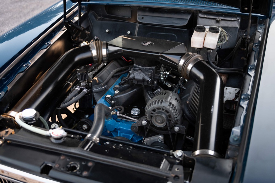

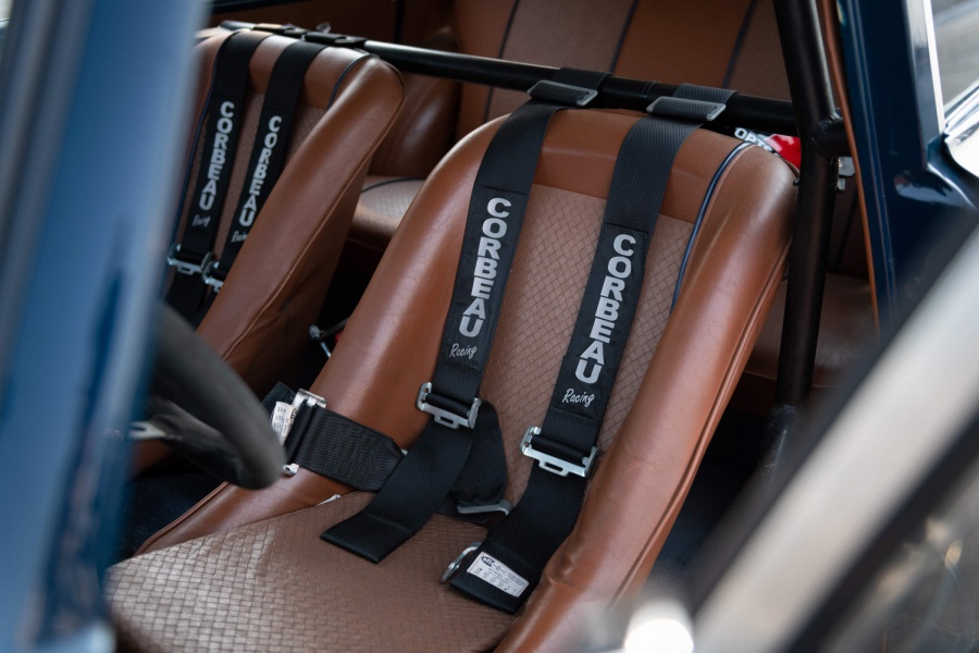

The Rambler was found in a northern California trailer park. “It was underneath a camper with a blue tarp over the top of it,” she laughed. The car had been sitting for a while, and the engine was sitting in the backseat of the car. The original plan was to have Suzy autocross the Rambler with the car’s original 195 cubic inch flathead-six engine and three-on-the-tree transmission in it as she worked on her autocross driving skill, but the moment she got behind the wheel of husband Rodney Prouty’s LS-swapped Camaro known as “Plane Jane”, that plan…and the expensive, freshly rebuilt flathead six…went out the window. In place of the original engine sits an LM7 5.3L V8 that is backed up to a 700R4 automatic equipped with a TCI Automotive Autocross valvebody and TCI ratchet shifter. The LS has recently made the move to a Holley Terminator X Stealth 4150 fuel injection system and a Holley LS Single Plane intake manifold after a few years of running carbureted. “It fires up stone-cold, it’s amazing,” Suzy says. “I really like it. I really like the throttle response. If I’m not careful, I burn out from a stop sign. My gas mileage is fantastic now. I don’t have to worry about running high-test fuel.”
With the powerplant sorted, the focus turns to the suspension. Rodney runs Suspension Geek, so you had better believe that the Rambler is meant to turn corners. The front subframe is a first-generation GM F-body unit with Global West upper A-Arms, Detroit Speed lower control arms and sway bar, and a steering box from a Chevrolet Celebrity. Out back, a fifth-generation Camaro’s independent rear suspension and sway bar were installed, lining up almost perfectly with the Rambler’s structure. Viking “Berzerker” active suspension coil-overs are found at all four corners, as are Baer Brakes 14-inch Pro+ six-piston brakes with Eradispeed rotors. The rolling stock consists of 18×10.5 U.S. Mags wheels and BFGoodrich Rival S rubber. Combined, these parts work to make the Rambler corner pancake-flat through the cones at high speed, and the shocks can be tuned from the sidelines via an app.

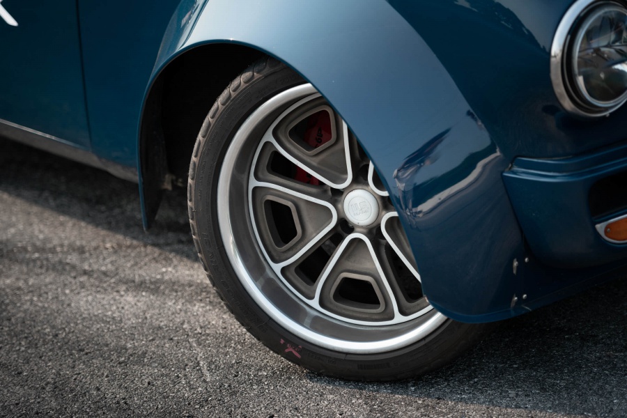

The body itself is fairly stock, except for the aforementioned wheel flares. Rob MacGregor of No Limit Engineering is the individual responsible for the creation of the flares that hide the 315-series tires at all four corners, and the car’s name (originally Suzy was going to call the car “Sugar”). In fact, MacGregor’s work and the Washington Blue paint laid down by Best of Show Coachworks in Escondido, California are the only two outsourced parts of the car. Everything else was done in Suzy and Rodney’s garage, from the suspension design to the engine build to the entire interior that Suzy put together. When the car debuted at the SEMA show in Las Vegas on Halloween 2017, jaws hit the floor all the way around. Jay Leno went for a ride. The car was nominated for the Gran Turismo Awards that year under “Best Hot Rod” by BangShift.com’s Brian Lohnes. The car won the Hot Wheels Legends 50th Anniversary Tour nomination at the Nashville, Tennessee stop the next year.
