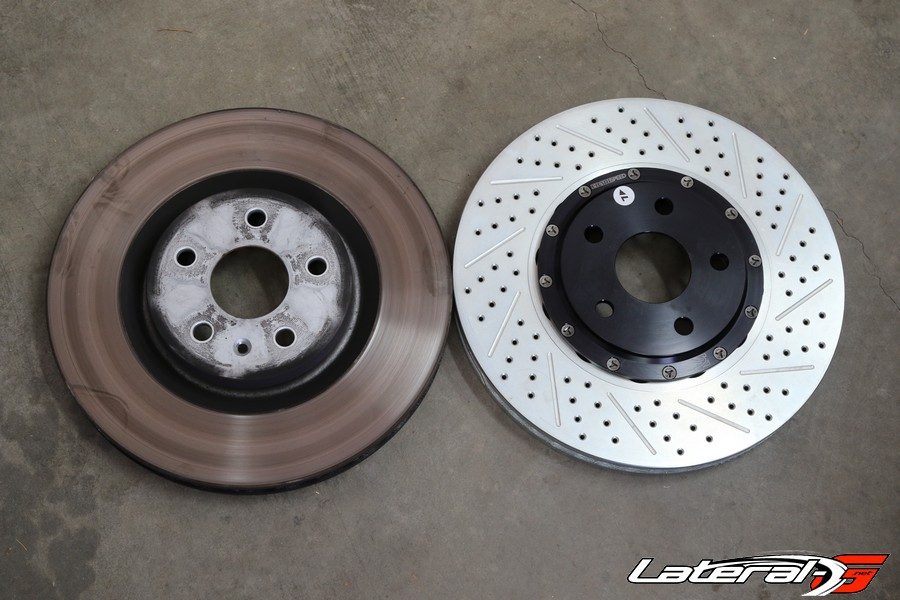

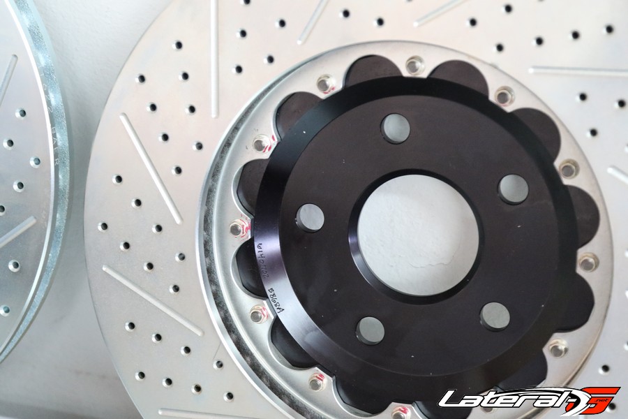

These are a two-piece rotor that are drilled and slotted. They are directional and only fit on either the right or left side.

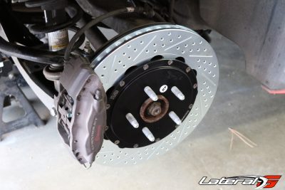

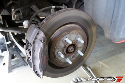

Installing the Eradi-Speed rotors was cake. After removing the wheels, we removed the brake caliper from the car. Mind you, the process the is the same for the fronts and rears. Once the factory rotors were slid off, we simply slid the new Eradi-Speed rotors back on and re-installed the calipers and wheels.

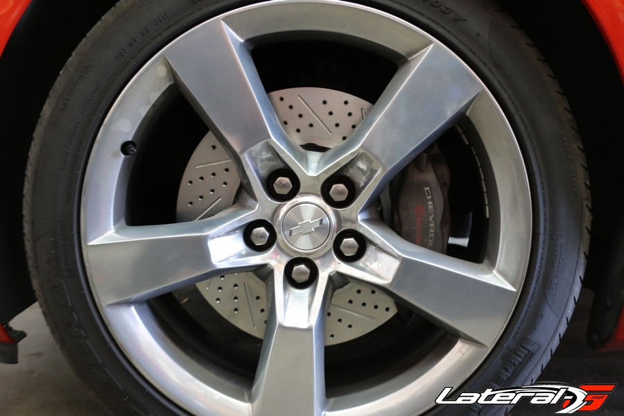

Hands down our favorite part is how bad ass they look! Going from a boring solid disc to a drilled and slotted disc made the car look better and more aggressive. With less than two hours for install, this was a home-run install in our book!
