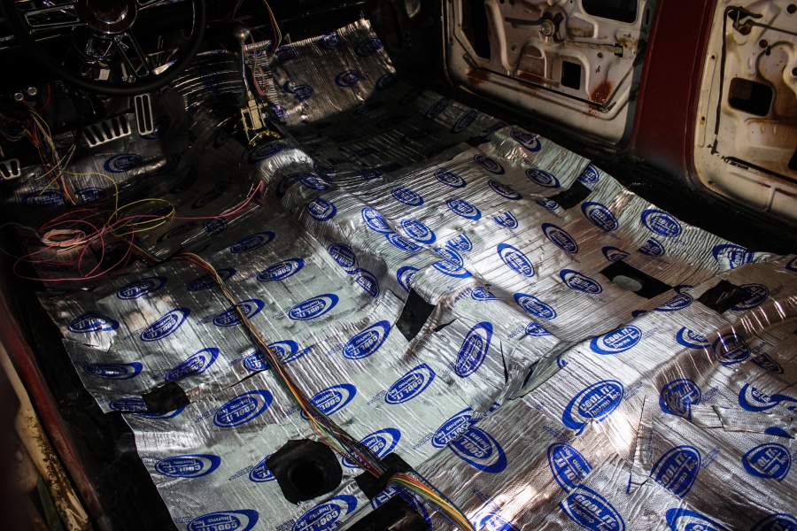

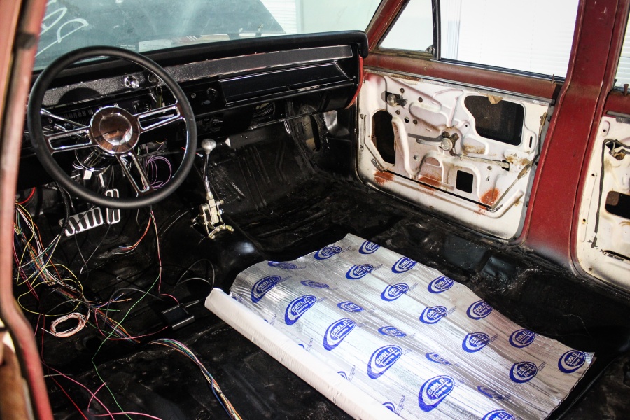

Installation of the Suppressor is really straight forward. You can cut it with a razor and make pieces that fit the area you’re trying to do. The Suppressor comes in a 3’x3′ sheet and we found that instead of trying to lay down one big piece at once, it’s easier to just cut little pieces. This is not only easier to work with, but makes it easier to conform the Suppressor to the bumps and contours of the floor as well.
What we did was roughly measure the area we wanted to install the Suppressor. Then with a razor blade we cut out the piece we needed then removed the paper backing. We laid down the piece and then used the dull end of a screwdriver handle to push down the insulation. We find that just pushing down by hand isn’t enough, you really need to work it around the bumps and ensure it’s stuck down.
We’ve used several different companies insulation before and this was our first time using Thermo-Tec. One thing that caught us off guard at first is the Suppressor isn’t insanely sticky. The other companies were. We quickly found out this was a great thing! This allowed us to remove the paper and get the piece in place before really locking it down the back of a screwdriver handle. The other companies as soon as it touches anything it sticks, including our hands! The Suppressor was way easier to handle and install. After rubbing the edges and middle with the screwdriver handle, it was definitely stuck in place though.
Overall the process is pretty easy though. We started with the firewall and slowly worked our way back, but there’s no right or wrong way to do it. We did make sure that we didn’t put any over seat belt or seat holes to make installation of those easy.
We did order enough of this to be able to do the entire floor and doors. For now we insulated the entire floor and will do the doors in the future. We have to rebuild those and the insulation will be the last piece. Just getting the floor done and then starting the car up we can tell a huge difference already! An easy upgrade for a few hours worth of work.
