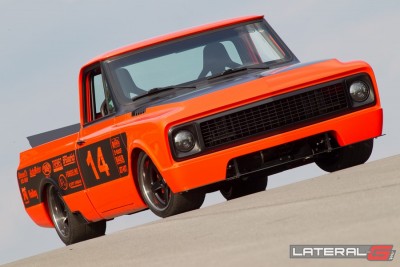

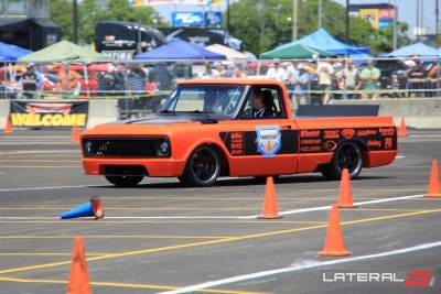

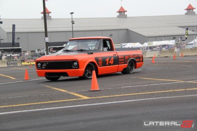

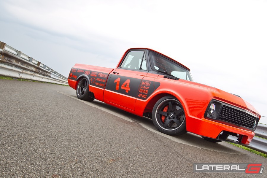

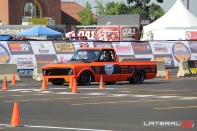

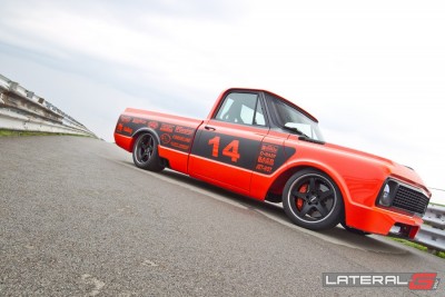

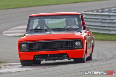

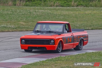

Bob is the proud owner of the 1969 C-10 you see here. We first caught a glimpse of this truck last summer at the Ohio Muscle Car Challenge, an event that he puts on. This event was held over two days and had a complete road course and auto cross challenge. Every time we looked, he was ripping down the track, keeping up with the best of them. Of course, we had to get a better look at the truck.
Orange Rush C10 Pro Touring Lateral G Bob Bertelson 1

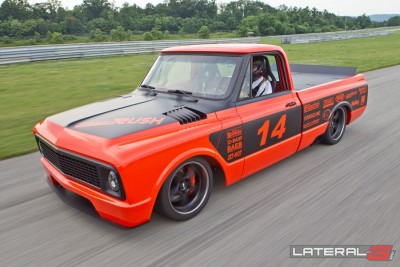

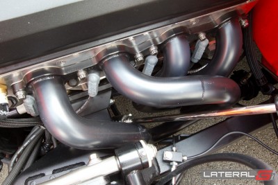

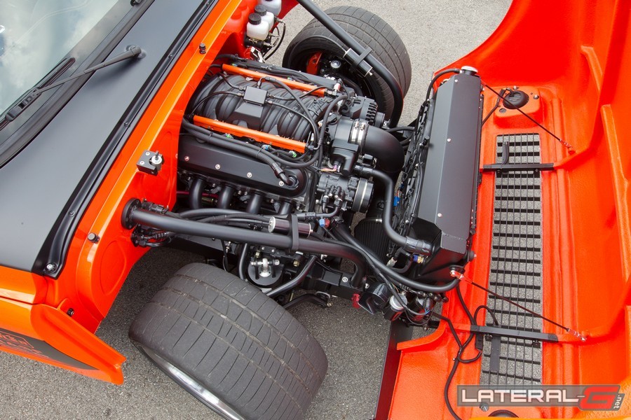

The truck started life as a 1969 C-10, but that’s about the end of the similarities. This truck has been completely gutted and rebuilt, using the latest technology and resources available. To start, the old worn out engine was removed in place of a Kurt Urban Performance LS7. This powerhouse of an engine pumps out 648 HP with 600 lb. ft. of torque. Backing all that power is a T-56 Magnum transmission, that has a Stage Two prep from Bowler Transmissions. With the truck having all the power it needs, it had to turn just as well.
Orange Rush C10 Pro Touring Lateral G Bob Bertelson 4
Naturally, all the original frame and suspension was long gone. These trucks couldn’t begin to handle as well as Bob’s. He made the frame himself, and fitted a Detroit Speed X595 Cross member, Control Arms and Spindles up front. Out back he utilized Detroit Speed’s Quadra Link Suspension, complete with a Moser Fab Housing, CR Racing True Trac and 3.70 polished rear gears.

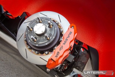

 To finish off the undercarriage, a complete set of Baer brakes was installed, making sure this truck stops like a Corvette and not like, well, a ’69 C-10! The wheels are a set of Forgeline CF3C’s, which are 18×11″ in the front and 18×12.5″ in the rear. Wrapping the wheels is a 315/30/18 BFG Rival in the front and 335/30/18 in the rear.

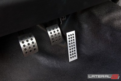

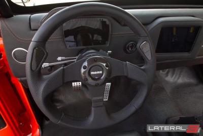

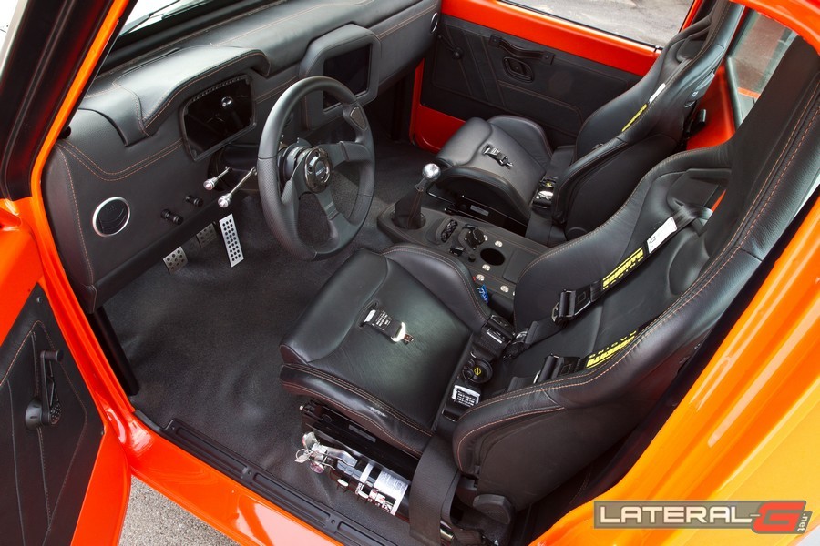

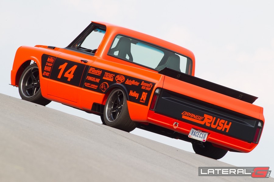

The inside of the truck is all race, with a set of Auto Meter LCD display gauges, a roll cage, and modern racing seats. On the outside, there are a ton of neat tricks as well. For instance, the entire front end is fiberglass and tilts forward. There is no bed floor, as the custom made cover keeps everything covered up. The rear spoiler is hydraulically controlled, allowing Bob to make changes with downforce on the fly.

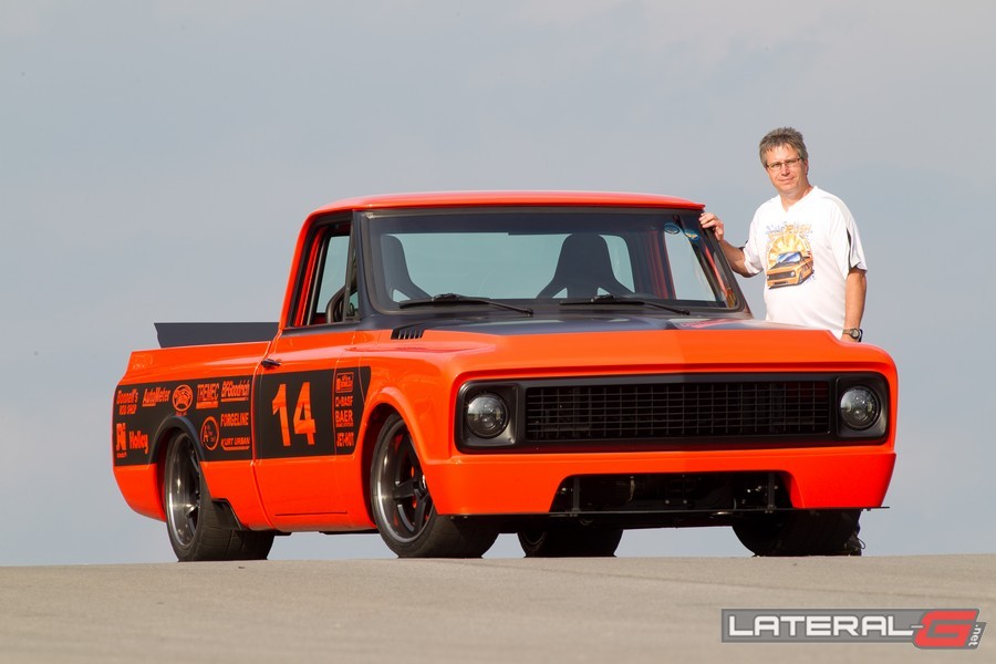

By far the coolest part of this truck is that Bob built the whole truck almost himself in a two car garage. He completed all the fiberglass work, fabrication, wiring, roll bar, assembly, and paint. Speaking of paint, the bright orange is R-M Diamont, Orange Rush Orange and Black Base with R-M 5335 Clear.
This truck is top notch and can easily win awards at a car show, then lay down the rubber on the track. Bob isn’t afraid to make that motor roar on the track either.
