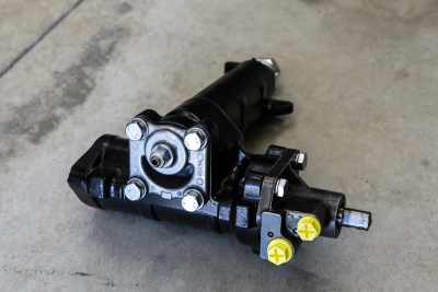

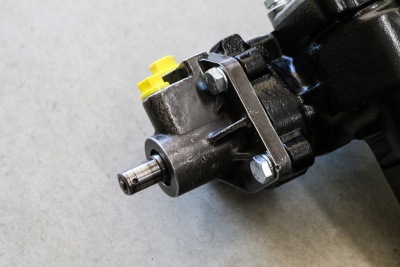

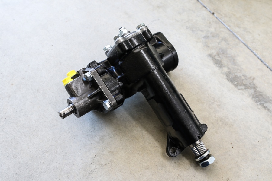

Fed up and at our wits end, we decided this junk box wasn’t worth it anymore. We called up Borgeson and ordered up a brand new box for this ’55 Bel Air. Last year we swapped in one of their boxes into a Square Body Chevy truck and it was a night and day difference. This box features 12.7:1 ratio and is a 600-series box. The best part is all the tech support we could need or parts for it in the future – something our old box didn’t have.

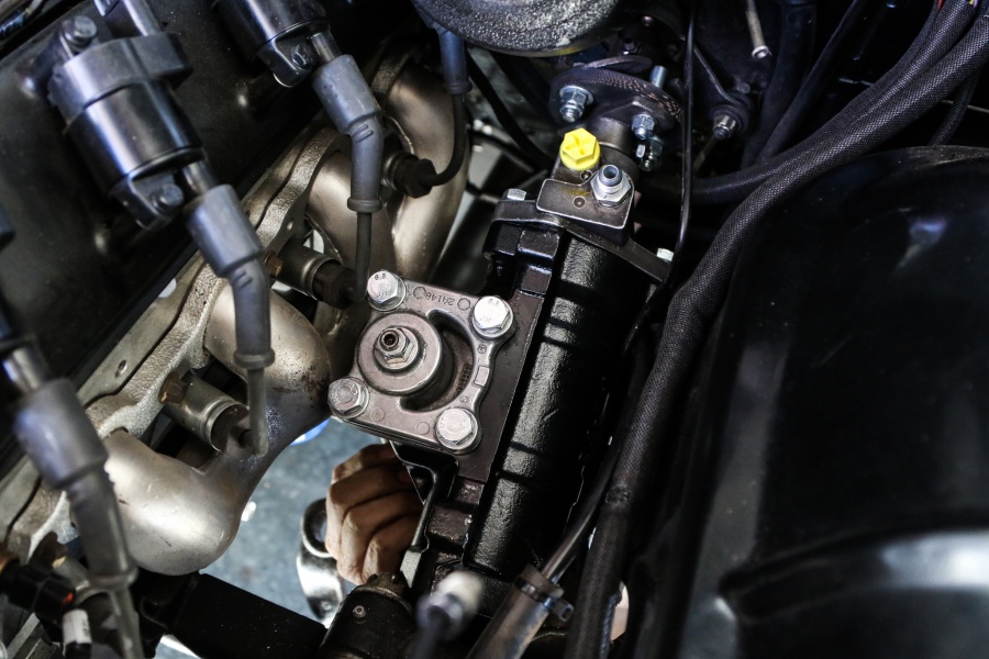

Installing the new Borgeson box is really straight forward. It’s designed to bolt right in and fit. Reading through the instructions one thing we noticed was that this box could hit the top of the frame and to keep an eye out for that. We did a trial run and found out our box did hit the frame. We chalk this up as our body has the original body bushing in it so it’s sagging a bit.
There’s several ways to gain that extra clearance and we decided to bust out our handy torch and bend down the frame a little bit for the clearance – we are talking about 1/4″ or so.

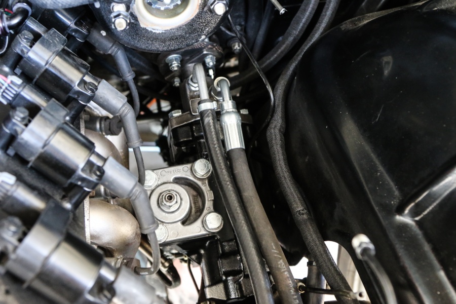

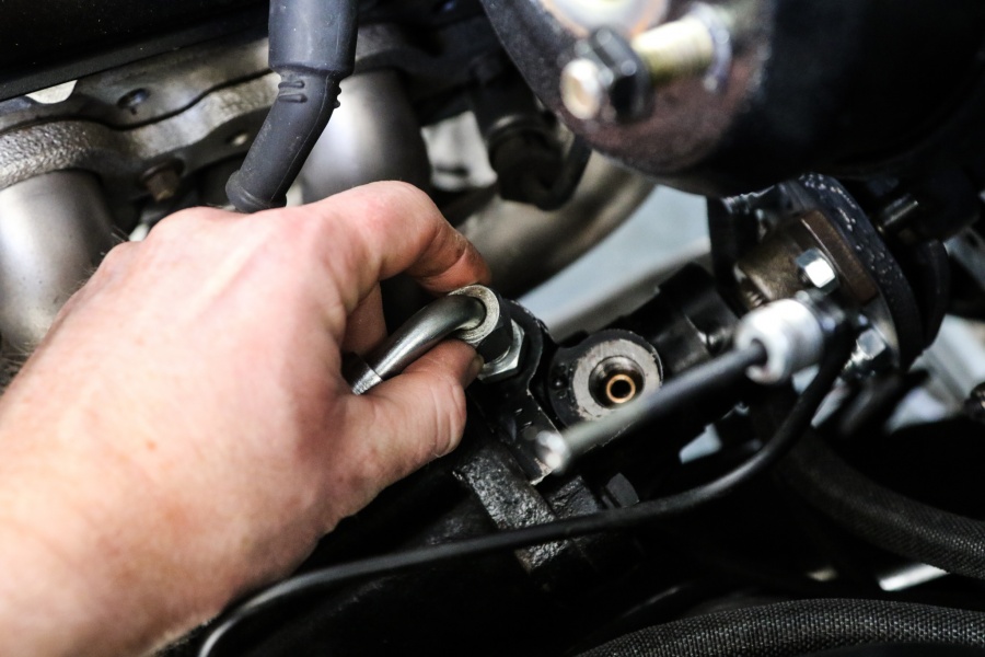

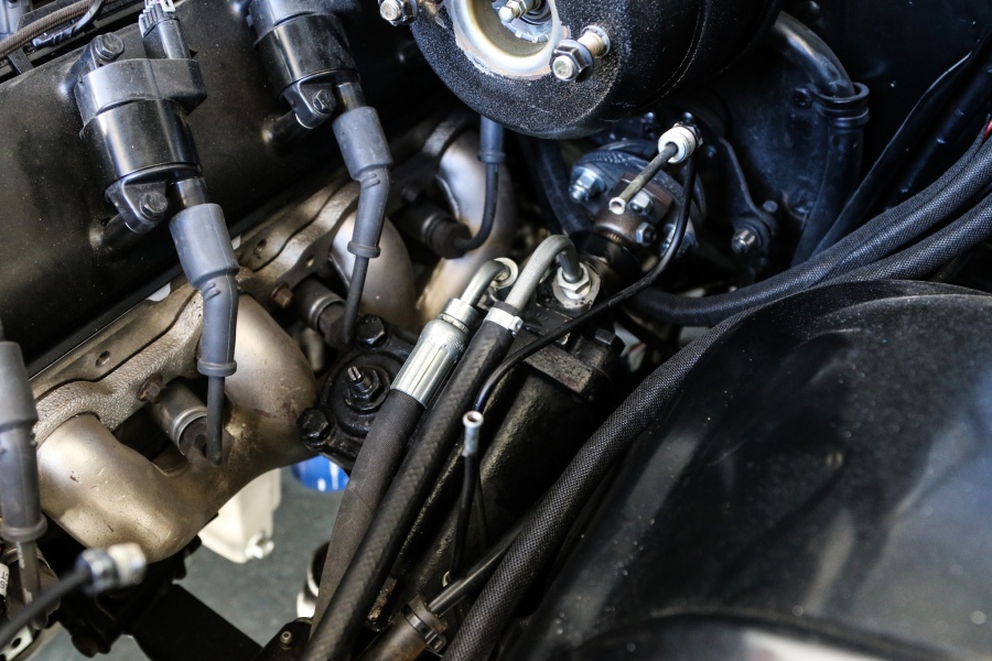

With the frame clearanced we bolted it up and attached the steering column back to the new box. The power steering lines screwed right in and then we installed and torqued down the pitman arm.
While the car was still in the air we added power steering fluid to the reservoir, fired the car and cycled the wheel back and forth several times to rid the system of air.
Lastly we installed the master cylinder and bled the brakes. Then it was time to hit the road! Our first impression was we were so happy that it didn’t leak. But then driving we noticed how much smoother, crisp and quieter the box was. The quality is definitely noticed not only in looks but the overall feel of the box too – that part we weren’t expecting.
