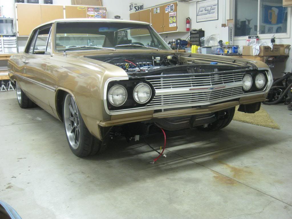

Finally a little forward progress. Got the oil pan back on and motor/trans back in. Got home to no electricity last night (again), so I proceeded to drop the body back on the frame using the braille method... Just about ready call it a night and the power came back on so I got it all squared up and fastened down. Here is the latest pic.

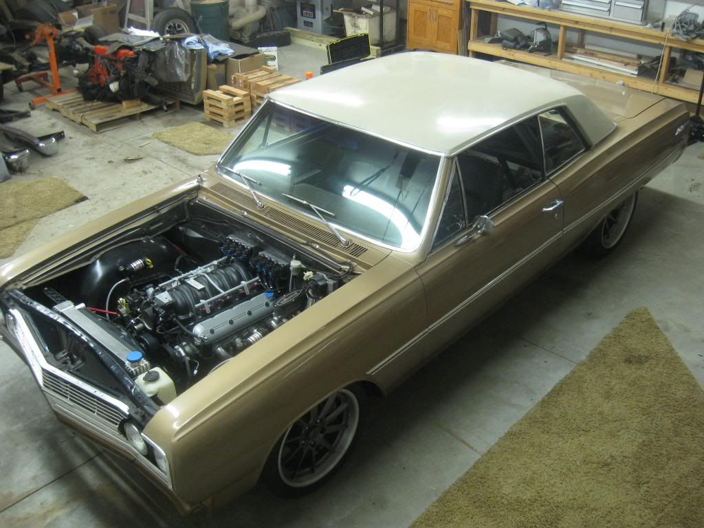

Pretty big update for Project G-Velle. "Thee" Chevelle guru from Mooresville Indiana is in the house cracking the whip
Mr. Tom Farrington graciously made the five hour trip to MI to help me do some thrashing on the car and man have we nocked the list down. Unfortunately, most of the things we got done weren't even on the list so you didn't get the satisfaction of marking them off the list Oh well, stuff needed to get done.
We are getting scary close to lighting it up. Of course there are some hurdles before we get there, but if the wind blows right tomorrow, we'll try to fire it. I had a personal goal of having it running by the Fourth of July, so right on schedule. He's heading home tomorrow and I'm sure he'd love to see it run as much as I do before he goes.
I can't even begin to thank Tom for his time and experience (and tools and supplies) he brings with him. He says he's paying me back for helping him on his 66 a few months back...I think I owe him now. Super friend.
Here is where we left it when we came in tonight, enjoy. You bet I'll have something up when it comes to life . Wish us luck guys.
