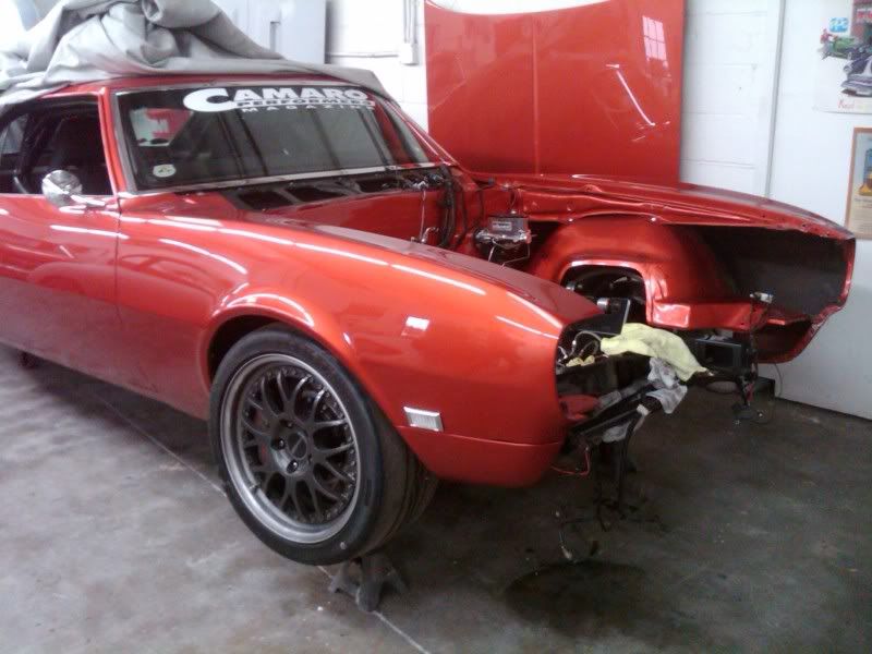

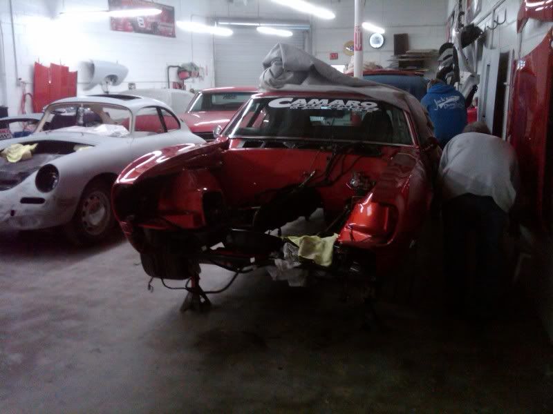

We started pulling the engine/trans today, but I had to split to go do a photo shoot of Driverz Inc's Nova.
The guys were nice enough to finish up the pull, I suppose I owe them some more beer or some Carne Asada.. lol
Matt Alcala snapped a few pics.. and to think I drove it into the shop.. I'm a sick sick person.
Thanks for sending me the pics Matt
