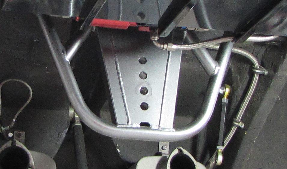

Bigger on the list was that David thought we needed more shock travel. Seems that were were on the stops durring hard turns and even on acceleration. We worked with Steve Duck over at RaceCar Dynamics and came up with a shock that's over two inches longer. The new Bilsteins are also revalved for the car. The extra length meant that we had to punch holes in the trunk floor so that this mount extender could be welded to the top of the existing brace. The top hole is for future changes if necessary. Dave sure lays down some nice welds!
Here Dave slides the new rear Bilstein shock into place. Later we scaled the car. The weight was 3290 with half a tank of gas. With a driver our cross weights are at 50/50 and the front rear are 52/48.
