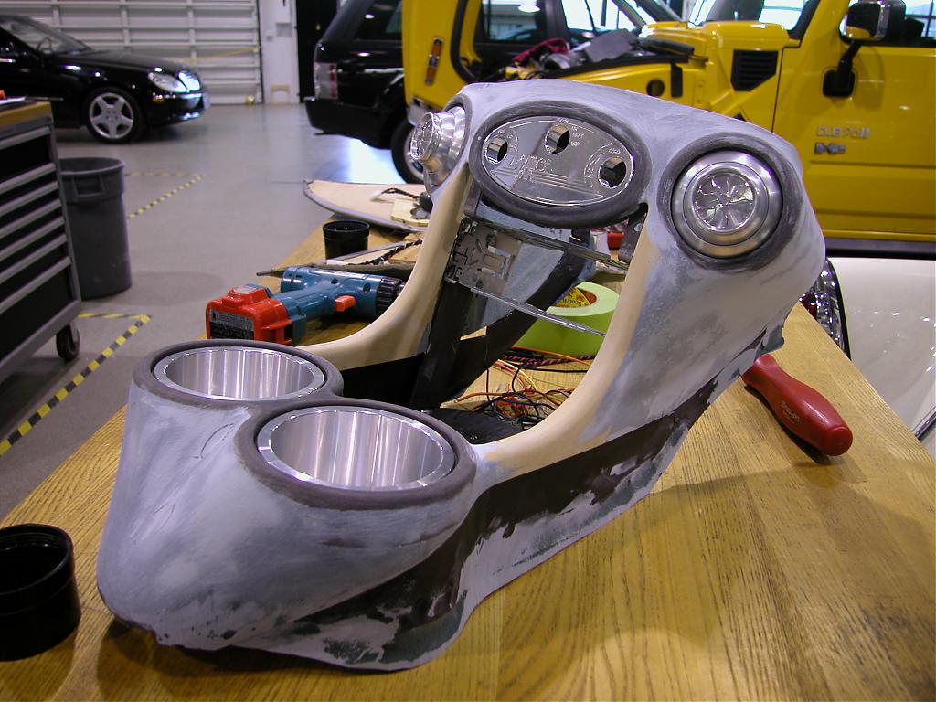

Here's the one in my NOMAD -- I bought BOAT cup holders out of aluminum - the painted part is fiberglass (easy to manipulate and shape) the rest is some steel frame - and wood and bondo ! The stereo faceplate is removable - when you do that - it 'unlocks' the fiberglass top piece and reveals a nice secret hiding spot...

GregWeld is your Nomad console painted or vinyl warped?

yeah gregweld that looks awesome but im also curious what the grey is. if its vinyl or what material. but thank you for the pictures there. start giving me some inspiration.
LowchevyII Maybe sneak some foot-well lighting in there. I like that look.
Thanks for the compliments ---
It's wrapped in little baby naughas... and carpet where you'd kick it... super easy to do - glue and a little heat and stretching....
I went with the curved look - because of the curves in the dash -- so that made it a little more complicated but not much.
