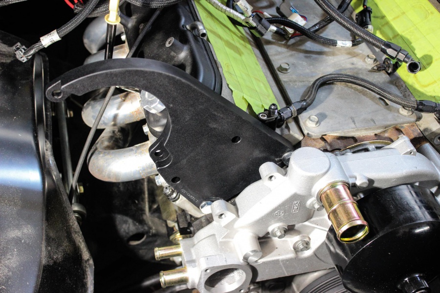

Starting with the instructions, we read them through a few times to make sure we understood the process before diving in. In reality, it’s a very simple installation where everything bolts together. The only semi-tricky part is you have to drill the crank and crank pulley to install a key to keep the crank pulley from spinning. Our first step was we needed a LS1 water pump which we picked up off RockAuto, along with an LS1 crank pulley, which we picked up from Summit Racing. First step was to get these installed.

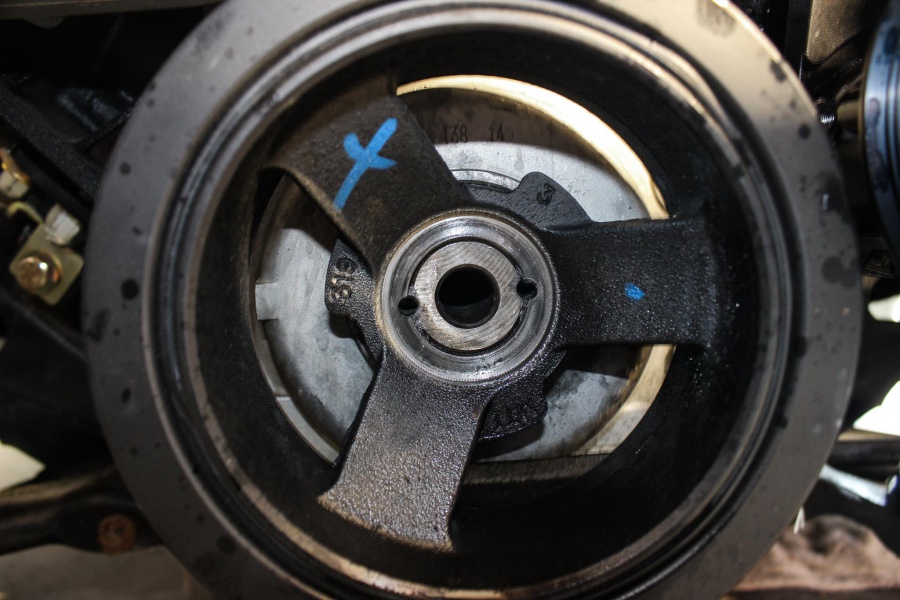

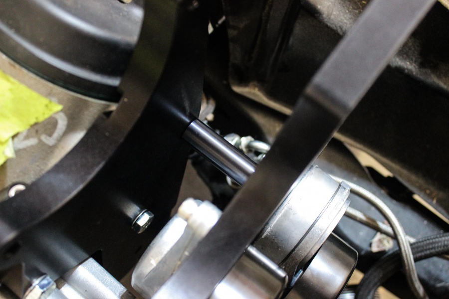

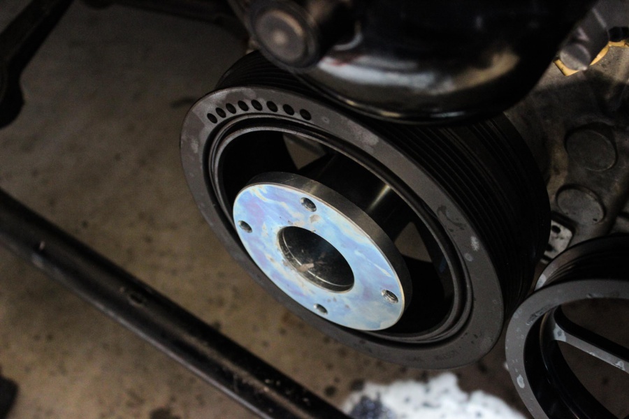

Before we started installing all the brackets we wanted to get this pinning of the crank out of the way. Luckily TorqStorm provides great instructions, a jig, and even the drill bit needed. The process was really easy where you installed a bolt with the jig, then taped the drill bit to mark it’s depth, then drilled two holes. After removing everything and cleaning it out, we tapped in the two pins before torquing down the supplied crank bolt with the pulley adapter. In this kit there’s a stand-off adapter that bolts to the crank that holds the pulley for the supercharger belt.

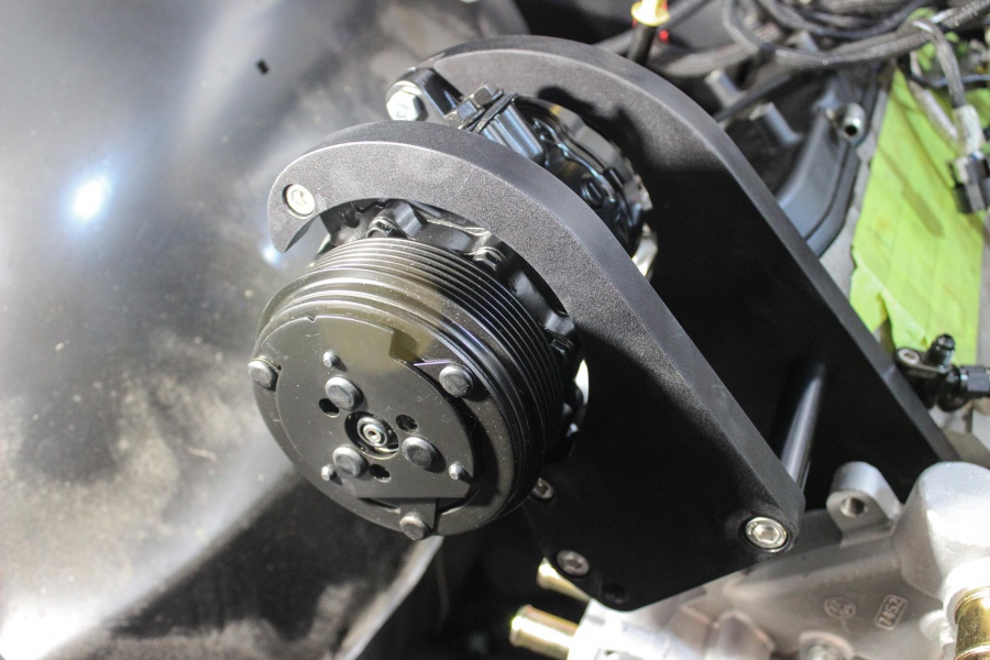

Moving onto the accessory set up, we started by installing the Air Conditioning compressor brackets and the compressor itself. There’s two brackets and a few adapters that make this all work, but it’s straight forward. The only tip we have here is to keep everything loose, then once everything is installed tighten it all up.

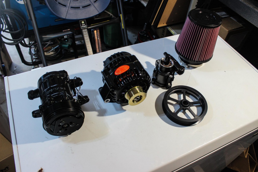

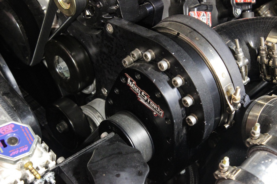

On the drivers side there’s two brackets that hold the alternator, power steering pump and the TorqStorm Supercharger. Included in this kit is a brand new black Powermaster alternator, Type II Power Steering pump and the supercharger. The outlet on the supercharger can be rotated around to fit best on your application. The entire accessory drive is ran off one belt with it’s own tensioner, while the supercharger runs off a separate belt in front with it’s own tensioner. Even with the extra pulleys and a big supercharger, the kit is really compact which worked out well for us.

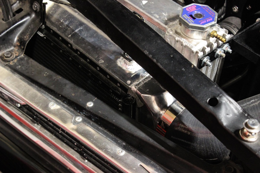

In a ’66 Chevelle, there isn’t much room by the core support. We knew that to get the best possible results we needed a big intercooler to keep the intake temps down to keep the engine safe with the boost. We measured, measured, remeasured, and measured again. We were about 51% sure we could fit a big 3″ thick Frostbite intercooler in front of the radiator. Our game plan was to scoot the radiator/fan back towards the engine about 1″, push the condenser forward about 1″, which would then give us the 3″ needed to get the intercooler in there since there was already a 1″ gap between the radiator and condenser.
Let’s just say this, it took a lot of cutting and measuring. There’s no kit for this step and we spent countless hours cutting, trimming, grinding and measuring to get it all to fit perfectly. The end result though is that we had an appropriate sized intercooler that will keep the engine making plenty of power. We even did the old “put a piece of paper in front” trick and the paper was glued to the condenser, showing us that we had tons of airflow through the intercooler with the Flex-A-Lite fan.

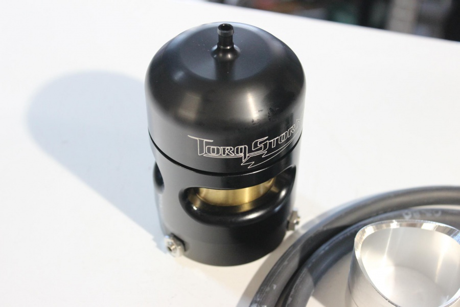

For all the piping we utilized Summit Racing elbows and piping, then had our friends at Pro Touring Texas tig weld in the blow off valve. When you open the hood there’s a lot going on, but it all has a spot and a purpose. Since the car had been sitting for so long with a battery that was ancient, we decided to pop in a fresh Optima red top to give this combo plenty of juice to fire up.
